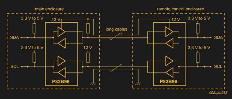

Bus Buffers
For long cable runs, some dedicated ICs can buffer the I²C signal, enabling the signals to run down a pair of wires with a much higher capacitance than what’s typically allowed on the I²C bus. The PCA9605 enables devices to run at the maximum allowable bus capacitance (400 pF) of the I²C spec. The PCA9605 takes that limit even further, allowing up to 4000 pF on the cable side.
The P82B96 does that, and a bit more. In addition to allowing a higher bus capacitance, it also enables the bus to run at a boosted voltage, making it even more noise immune. What’s more, the P82B96 can even be optoisolated, enabling interaction between devices on dissimilar power supplies. The datasheet boasts carrying an I²C signal across cables for up to 20-meter cables. Furthermore, by dropping additional P82B96 devices downstream along the cable, the signal can be boosted and regenerated to travel even farther.
Keep in mind that systems with P82B96 chips will come in pairs, as shown above. This pairing is necessary to take the boosted I²C signal from one chip and re-encode as conventional I²C with a bus voltage that’s sane enough for our remaining I²C devices.

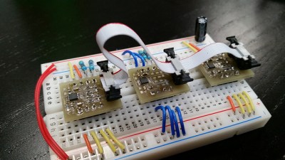

Differential Bus Buffers
While some bus buffers simply boost the voltages of the I²C bus, others re-encode it as a differential signal. The PCA9615 does just that. It encodes the SDA and SCL lines into two split differential pairs. Differential pairs are one step short of magic. By sending equal-and-opposite signals over two wires spaced closely together, we make the signal far more noise immune than simply by boosting the voltage. (More on differential signals and the PCA9615 in an upcoming post!)
Of all the solutions so far, this one’s my personal fave. Not only do we get all of the noise immunity benefits of differential signals, we also don’t sacrifice the main benefit of I²C: that it is a shared bus and, hence, only a small number of wires. On that note, this chip also supports a multidrop configuration, making it a true off-board extension of the protocol.
In the diagram above, the large bounding boxes reflect multiple PCBs–each of which is connected at arbitrary points along the same cable. By far, my best bet at taking this diagram and turning it into real components was to start with ribbon cable and simply crimp connectors along the cable like so. (Those cable lengths, however, can span a few meters without any problems.)
With typical bus buffers, sending a boosted signal across a ribbon cable would still introduce the possibility of EMI in the noisiest environments. With a differential signal, that’s no issue, provided that each pair is closely spaced together on the cable.
As opposed to the prior solutions, each node that connects to this setup has the same topology, just one PCA9615 per drop. There’s one exception, though. The final drop needs to have termination resistors that complete the differential pair topology.

The P82B96 doesn’t seem to be much of a step up from the FET output it replaces, it’s still unipolar drive. It would have been good to see the others.
Op-amps and differential signalling are your friends here.
I have a commercial product that uses the P82B96 to run I2C over cables up to 250 feet long. Passed CE immunity with capacitive coupling to the cable shield. (Testing this was a bit inconvenient!) Pull up is to 12VDC. SCK runs at 40 kHz.
