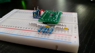

I mocked up a quick test setup to have a go at this chip in real life.
The LTC4316 sits in-between our address-clashing device and the rest of the I²C bus, acting as a temporary check valve. When an address is sent along the line, it’s translated in-flight to the “private” SDA line that the address-clashing device sees.
Once all seven address bits have flown by, the private SDA line is immediately reconnected to the system I²C bus (no more check valve) such that the address-clashing device can reply with an ACKnowledge if it was selected by the bus master. If it was selected, conversation proceeds as normal until the end of the transmission, at which point the private SDA line is disconnected again to setup for the next I²C transmission. As for when this disconnect happens exactly, the datasheet doesn’t specify, although I suspect it’s immediately after the I²C transmission finishes.
Setting the appropriate address is a matter of spec-ing the right voltages at the pins XORL and XORH. each voltage dictates the upper three and lower four translation bits for the devices internal XOR logic. To determine the exact translation byte we want, we follow two steps. First figure out what address we’d like our system bus to use to talk to the address-clashing device. Then we need to know the address-clashing device’s default address. With those two addresses, we then follow the equation:

To set the right voltages, the datasheet recommends a voltage divider. At first glance, this option seems somewhat power-inefficient. Luckily, the datasheet suggests resistors in the 100Â kilohm range, which should be good enough for all but the tightest of power constraints.

I’m in the market for a heat shrink labeler… I’d like to know how you like what you have and where can I buy one :-)
Thanks
Wow. I didn’t realize this was a real thing. I’ve been printing labels on paper then sliding them inside clear heatshrink tubing for years. This would be a huge time saver. :)
I used to have one at work, but it was a keypad type.So I was more often then not just pulling out a sharpie and hand writing the labels…
Aye, it’s the Brady BMP21-PLUS Handheld Label Printer. I have one at my current gig, so I used to just buy the permasleeve cartridges and print labels there. A few months later, I could totally justify getting one. A few labels go a long way in ruling out uncertainty. ..
I can recommend the Brother PTouch P700. It’s USB connected, has a nice windows-only utility (works within virtualbox).
Drawbacks:
1. it wastes about a centimetre of tape per print job, so if you want to print multiple labels it can be advantageous to prepare a spreadsheet and use that as datasource
2. It is not possible to print an inverted color label, so if you print a barcode on al black label with white text you cannot read it (at least using a smartphone barcode scanner app I tried, didn’t try a real scanner).
Otherwise the software is good, the printer is nice and there are multiple third party label cartridge makers.

wow, i’ve been thinking lately about how awful my breadboards always turn out, little nests of chaos. but this article helped me realize, my boards look that way because i don’t photograph them.

Much more important. You can label heat shrink tubes?
Sorry, I need to go shopping!
