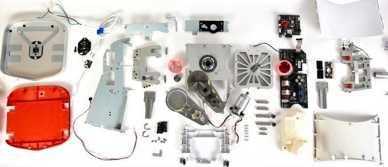

Ben Einstein, a product designer and founder at Bolt, a hardware-based VC, recently got his hands on a Juicero Press. This desktop juice press that only works with proprietary pouches filled with chopped fruits and vegetables is currently bandied in the tech press as evidence Silicon Valley has gone mad, there is no future in building hardware, and the Internet of Things is a pox on civilization. Hey, at least they got the last one right.
This iFixit-style tear down digs into the Juicero mixer in all its gory details. It’s beautiful, it’s a marvel of technology, and given the engineering that went into this machine, it was doomed to fail. Not because it didn’t accomplish the task at hand, but because it does so with a level of engineering overkill that’s delightful to look at but devastating to the production cost.
Maybe It Wasn’t Just the Engineering…
Type ‘Juicero’ into Google News and you’ll see Silicon Valley was shaken to its core this month. The future of hardware startups is now in question. Juicero, the world’s first cold-pressed juicing system, is in a tailspin. This company that raised $100 Million in funding is now being compared to Theranos, Uber, Enron, and every other corporate pariah in recent memory. The creator of Juicero, once favorably compared to Steve Jobs is now doing damage control with every outlet available.
Maybe, just maybe, the idea of a machine that would squeeze pre-packaged crushed fruits and vegetables into juice isn’t a great idea. The machine originally cost $700 USD, and the juice packs were purchased through a subscription model for $35 per week. For $2500, you could have all the fresh squeezed juice you want for an entire year. Maybe consumers don’t like the idea of DRM in their food. Juicero was a fantastic success for its creator, as the $100 Million in funding goes to show. For the rest of us, we’re left with a fantastic lesson on when you should engineer less, not more.
Just Look at It!
Disregarding the madness surrounding a $700 juice machine that uses proprietary, DRM’ed juice packs, the idea that anyone would spend two thousand dollars on juice per year, and the concept that a machine that makes juice is a bellwether for the entire economy, one marvelous thing did come out of this little kerfluffle. We get to look at design choices the likes of which are never seen in a single product.
Ben’s teardown covers the huge plastic enclosure, and the eight mold revisions required to bring this product to market. If you’re not familiar with injection molding, it’s expensive, and you really, really want to minimize how many mold revisions go into your first product. The best designers can finalize a mold in two or three revisions. It took Juicero eight, probably at a cost of over a million dollars.
The teardown continues to the power supply, a massive, custom job that converts wall power to 330V DC for the motor and 3.3, 5, and 12V for the brain of the device. The ‘transmission’ for this device consists of at least five machined, hardened gears. Our ‘ol pal [AvE] will tell you machined gears are rare in the finest prosumer grade DEWALT or Milwaukee tools — they usually go with cheaper sintered metal gears. By all accounts, the Juicero is an exercise in excess.
The Juicero is a machine that is overbuilt, overengineered, and the cost to make this machine prices it out of the market of people who would actually want a desktop juicing machine. While Juicero could iterate on this design for a few more revisions, replace the expensive machined parts for stamped steel, and simplify everything, even that would be insufficient. The design of the Juicero has a fatal flaw: it compresses the entire juice pack at once. That’s sixty-four square inches of fruit and vegetable pulp that must be compressed all at once. In an article that will surely be featured in next year’s Pulitzer nominations, Bloomberg discovered you can simply squeeze these juice bags. The Juicero isn’t just over-engineered. You could squeeze this bag through rollers with a simpler mechanism to get the same amount of juice out.

Another unnecessary complexity is they used a computer controlled high volt DC motor when they could have gotten away with a simple commodity AC gear motor.
Not defending the ol’ Juicero by any means, but the teardown article assumes the mold was made 8 times because “Rev H” was stamped on the inside. This is a massive jump to conclusions!
Rev H could mean anything, typically you get a preliminary quote using designation “Rev A”, then work with the molder making design changes until you are ready to order a mold. During this time, each design you send to the molder is tracked with revision numbers or letter to ensure they are working with the latest design files. It could be that they got the tool right on the first try, but they used the Rev H design files.
It is also possible, that the mold is just modified for the revision. Welding some metal on to reduce the amount of plastic somewhere or grind something off to increase a wall thickness. I don’t know how difficult it is to add features like sliders later on, but at least it is possible that only one half of the mold has to be redone. So I am quite sure that not 8 complete molds have been built.
Exactly! I enjoyed the legit criticisms of exorbitant cost to make this product, but you can’t cheat and start piling on false accusations.
They almost certainly didn’t make the mold 8 times, most of the time you only need to make one mold and if there is a big mistake or design change you will have to retool once. 3d printers exist so we don’t have to make injection molds just to test fit and function.
This is Benchoff you’re dealing with here.
LOL.
Yep, we’ve been benchoff’ed again.
He was just repeating what the linked article said.
Or just changing gate locations, adding more venting. Lot of potential minor changes that still lock up up a rev level. At the drawing level, just changing notes or adding/subtracting inspection dimensions will uprev a document
Hahah I didn’t catch that either. Yes the cordless drill motor draws 1.6 kilowatts and requires its own dedicated circuit in your house. Pretty sloppy technical checking in this article.
typical for Brian, expect him to correct the article and delete your comments, or throw a tantrum and call you all trolls.
I’m not dogging on Brian, just the writer of the original article he linked to.
Read the specs; they list two models. One is a 24V motor with only 5.32A stall current. The other is an 18V motor with 130A stall current — that’s 2.3kW right there.
Also, those specs are for the “JQ42-57” series, where 42 would probably indicate the rotor diameter, and 57 the rotor length. The motor in the Juicero is labeled “JQ42-1210N15A” (no spaces), so the rotor is probably 121mm — over twice as long. (The teardown article calls the part number “JQ42-1210N1” and seems to treat the “5A” as a stall current, but I’m not sure that’s right.)
So I don’t find it at all implausible that this larger motor could be wound for 330VDC and 5A (or more) stall current.
And as for dedicated circuits, just because you’re using a motor that pulls 5A (or more) at stall, doesn’t mean you have to have a power supply capable of feeding it 5A — you can use a polyfuse or circuit breaker, of course, or simply monitor the RPM (the Juicero has an encoder on the motor), and kill power if it falls below a speed corresponding to the maximum current you are prepared to draw.
You’re right that the voltage is plausible. Read my comment below. I laughed at first because 5A at 330V sounds ridiculous for something that dispenses juice. In fact, it is entirely possible that because of the wacky design they needed this much power.
Some of the really nice (read “really expensive”) cordless drills out there are actually capable of such power ;-)
Why should 1,6kW require a dedicated circuit? A Normal circuit (230V/16A) delivers 3,6kW and you need just a bridge rectifier and a cap to get 330VDC from it. Even from 110/120V you only need a voltage doubler or PFC circuit like in a PC PSU.
The typical circuit in the US is 120V / 15A so something that continuously draws 1.6 kW would probably need a dedicated circuit. We put our refrigerators and microwaves on dedicated circuits these days.. I was going off the article which said it draws 5A at 330V, that sounded ridiculous at first glance for a cordless drill motor, but who knows maybe it’s custom made that way to reduce size of the wiring.
Actually I don’t know what I’m talking about with motors either, maybe 330V is right – it is printed on the motor. It could have been custom made for them which would explain why it doesn’t match the datasheet. A 330V motor would have lower current draw so you can use more manageable wires, etc. Who’s to say it isn’t right.
The motor in the picture is a JQ42/1210N115A
The link is to the closest match on the website: JQ42/57 series motor. Just guessing, the JQ42 is probably just frame size, and the rest of the part number most likely refers to the electrics. The data sheet doesn’t show any data for the JQ42/12 series motors, Just the JQ42/57.
There is also a 330 VDC reference point silkscreened onto the circuit board.
You’re exactly right. The designers will start with ‘A’, then test this in modeling and 3D printing, so some structural analysis and then tweak. Given the state of modeling tools these days, it’s quite possible that the molded parts worked fine the first time.
The motor is actually 330Volts. The link goes to a similar low voltage version of the motor as there is no link to that exact motors spec as it’s custom built.
I see lots of high power, phase synchronous motors of this voltage in appliances such as washing machines. That’s because our mains voltage here is 240Volts AC and when that is bridge rectified you get 338Volts DC. Then the motor phase controls just have to be a cheap TRIAC per phase. I’d imagine the design is from Europe where they have 230Volts AC which rectifies to 324 Volts.
But it’s a stupid proposition to use this motor voltage for 120Volt regions because that takes the power supply design from being a simple bridge rectifier to being a far more complex and expensive switch-mode boost converter.
A cheap voltage doubler would work nicely to get 340V DC from 120V AC.
50/60 Hz voltage doublers are only cheap for low power applications. Once you need more current you have to quite dramatically increase the capacitance value and, high value, high voltage capacitors are not cheap.
You would need for PFC anyway in most regions if you have smoothing caps. You don’t need perfect filtering just for a motor. I know of kitchen appliances (Handmixer, handheld blender) which use permanent magnet DC motors (probably of similar size, spec’d for 300W – for 2min) which just use a bridge rectifier for the motor. The small motors in hairdryers too, they just use part of the heating coil as voltage divider or dropper resistor and 4 diodes.
So yes, if you want to go cheap you have to select a motor which suits your mains voltage.
Why even use a DC motor as a shunt motor like in a drill could do the job with no rectifier?
As for control two relays it doesn’t need to be super accurate heck it would be possible to make the thing work well enough without any kind of controller at a all.
I don’t know what you mean by ‘shunt motor’ but if you mean ‘shaded pole’ then they aren’t suitable because they are not very efficient. A shaded pole is fine for low power applications like a 50Watt pedestal fan where the 15 watts of heat can be blown away but at 1500Watts you would need to get rid of 450Watts of heat.
The power supply has two opto-couples. They aren’t for the low voltage side as that’s a basic transformer. So they must be for motor control, suggesting that the voltage to the motor fluctuates under control from the micro. One opto is probably on-off and the other PWM.
I think you meant a “universal motor”.
https://en.wikipedia.org/wiki/Universal_motor

They need the very expensive machined gears because of the drive/press system they chose which seems to me to be the stupidest option they could have chosen.
What they lacked is clearly an experienced system/design architect. Probably because they were stuck in the startup “we need young innovative people” mindset that is so patently bullshit. Here’s a hint, being ignorant of the state of the art (And thus the way things have been done that DON’T work) is NOT a good way to design a product.
Having looked at the actual teardown now I will add:
Holy hell they did NOT bother looking at easy off the shelf solutions. That thing is constructed more complicated than many of the systems I work with in my day job (And that’s state of the art semiconductor photo-lithography equipment where cost is usually the last consideration). That door locking mechanism alone (O.O)
Very obviously they never bothered doing anything with off the shelf components even when they would quite possibly have been cheaper off.
Once Juicero falls over I hope some of the engineers involved will give us more insight into the process that led to this abomination of a machine.
Throw lots of money at something and your team feels the need to spend it on pimping out everything and it starts to become a company wide mindset. Remember the dot com era? Seems fairly clear what lead to this outcome.
However, I am not as quick to criticize the overall outcome. Even if it is vastly overkill and the cost to produce it will limit the market penetration, the hardware engineering and attention to detail does seem at first glance to be fairly glorious.
Also, shoving off the shelf parts into things isn’t always as easy or cost saving as you might think and what if something gets discontinued or modified which causes the whole supply chain to break because they didn’t consider your process when making that change.
It’s not glorious – it’s stupid and the concept is even, Clearly thought up by some cool kids who hired a equally young and stupid engineer who didn’t know anything to concoct a monstrosity.

I have seen $10000+ precision instruments made far more cheaply than this. A flat press is a really bad way to do things unless you have to, and there has to be a better way to use mechanical advantage

It frustrates me how the teardown refers to the machine as “beautiful engineering” – engineering is about balancing many requirements and constraints, but this machine is a horrific overkill monster. It’s not that hard to make a nice geared press mechanism. Just because it has expensive machined parts doesn’t make it beautiful engineering.
But on the other hand, you have a good point – maybe they actually did do a good job working within their constraints, becuase actually they had a high cost target. You want a $700 dollar machine? You get a $700 machine!

This thing is not over engineered, it’s foolishly designed. The relevant quote is from Neville Shute, “an engineer is a man who can do for ten shillings what any fool can do for a pound”

“overengineered” is an ambiguous term broadly applied to any design aspect which non-engineers dislike.
These non-engineering types typically like to consider themselves technically above-average yet never actually been in the position to design a product for a paying customer or really contribute to society in any technical way.
I look at this project and see a design-by-committee project farmed out to engineers who although might be good at their job, lack the communication channel to create a decent product.
This lack of communication is likely due to different languages or the committee being assholes. Revision H on the mold tool is a good indicator.
