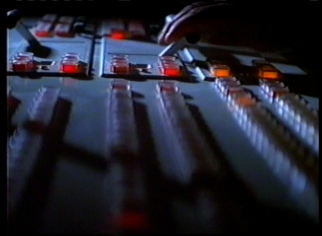

Regarding those broadcast switcher buttons, they’re great for stuff like this. New they’re quite expensive, but I’ve seen old Grass Valley switcher panels on eBay for as little as $50, and I’ve been pondering picking up one or two to harvest their buttons.
Just make sure you use it for good, ok?
[img]http://4.bp.blogspot.com/_ONdqiKabyPQ/TLIFp8olLhI/AAAAAAAAADU/eGDsCX148mk/s1600/Image12.jpg[/img]
oh, just copy/paste the link… :)
For those not in the loop: Grass Valley Group video switcher, aka Death Star firing panel.
