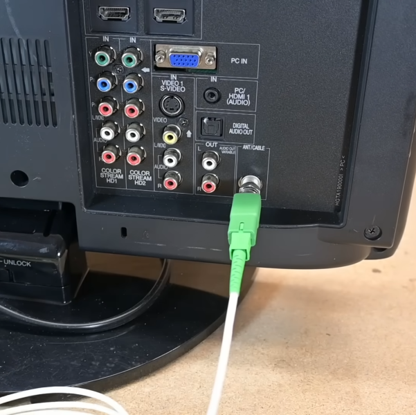

In his regular browsing on AliExpress, [Ben Jeffrey] came across something he didn’t understand—a $5 fiber optic to RF cable TV adapter. It was excessively cheap, and even more mysteriously, this thing didn’t even need power. He had to know how it worked, so he bought one and got down to tinkering with it.
Inside the device in question.
[Ben] needed some hardware to test the device with, so he spent $77 on a RF-to-fiber converter and a cheap composite-to-RF modulator so he could test the $5 fiber-to-RF part. A grand expenditure to explore a $5 device, but a necessary sacrifice for the investigation. Once [Ben] hooked up a fiber optic signal to the converter, he was amazed to see it doing its job properly. It was converting the incoming video stream to RF, and it could readily be tuned in on a TV, where the video appeared clean and true.
It was disassembly that showed how simple these devices really are. Because they’re one-way converters, they simply need to convert a changing light signal into an RF signal. Inside the adapter is a photodiode which picks up the incoming light, and with the aid of a few passives, the current it generates from that light becomes the RF signal fed into the TV. There’s no need for a separate power source—the photodiode effectively works like a solar panel, getting the power from the incoming light itself. The part is ultimately cheap for one reason—there just isn’t that much to it!

      3. Why would it be noisy? Light should have LESS noise.
        I would think if there is so much noise it’s the amplifier that drives the LASER, but then you can just use a better amp surely. Same for dynamic range, good amp and suitable LASER should do the trick, although high quality LASERS can get expensive I suppose.
        And to Volt-K: I can see tons of reason, like the damn issues with ground on antenna systems, especially cable (I’ve measured hundreds of volts on cable’s ground compared to earth ground, and I’ve seen cable installers yelp from being zapped). And how about lightning? Seems having fiber in between would be a good protection from places that need to be extra safe. And it would be good against EMP’s too I would think.
        1. Anything generates noise – the effective resistance of the photodiode is extremely high, hence extremely high noise relative to thermal.
          The noise figure of a directly modulated RFoF link with no preamp is like 20 dB, whereas you can get RF amps that add so little noise it’s better measured in kelvin.
          And those are the good ones: crappy ones have a noise figure as high as 40 dB.
          1. Being noisy isn’t a deal breaker, it’s just a downside. You can work around it for most situations. You just need signal.
            These aren’t opinions, they’re just facts. I’ve tested and characterized buckets of RFoF and helped design custom ones.
    1. Nope,
      the TV supplies power over Coax. Just like it would do for an “active antenna” (an antenna with an embedded signal booster).
      The article is simply wrong. The miniscule nanoWatts that arrive via the light on the Fiber are not enough to do anything with passive components.
      If you look at the image above, you can clearly see 3 pins on the optical receiver. That is a PhotoTransistor. You need enough power for the Bias Current. That is supplied via the Coax input on the TV. NanoWatts are not enough for it.
