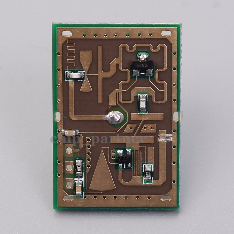

I just had to know what was in that can on the HFS-DC06. My searching led me to this nifty planar design.
http://i.ebayimg.com/00/s/ODAwWDgwMA==/z/eUAAAOSw4shX9GYB/$_57.JPG
Thanks. Was wondering as well.
What is with the copper ‘triangle’ with one rounded side?
I don’t understand a lot about circuit design, so sorry if it’s an ignorant question.
This is distributed circuit design as opposed to a lumped element design, therefore there is nothing trivial or obvious about it. What you are seeing are radial stubs. You can read about them here:
https://www.microwaves101.com/encyclopedias/quarter-wave-tricks
The radial stub in the lower left is part of a bias tee connected to a discrete transistor in an oscillator circuit. The thin trace that feeds the tip should be ~1/4 wavelength. The radial stub is sized large to act as a capacitor or high frequency shunt.
Thanks!
