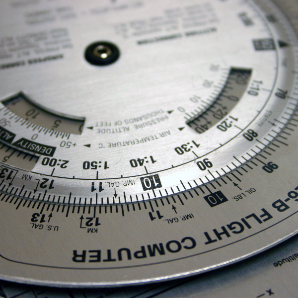

Besides, they are almost a perfect backup computer. Small, light, cheap, not prone to breaking, and they need no power. Some are made of cardboard, some of metal, and others of plastic. Wartime E6Bs were on a plastic that glowed under cockpit illumination. Later, there would be electronic or software E6Bs (see the video below), but a real whiz wheel is something you can hold in your hand, and you never have to change the battery.
Not Just a Slide Rule
The front of the E6B is, essentially, a circular slide rule. What makes it unique, though, is that it has special scales and markings to deal with conversions of things like nautical miles or knots. Even the arrangement of the scales work to make a pilot’s life easier.
For example, the top of the wheel is a big mark that represents 60. Why? Because there are 60 minutes in an hour, and this makes it easy to compute things like pounds of fuel per hour.
It also lets you convert things like knots to nautical miles easily because the conversion factors are marked already.
If you know how to use a slide rule, you are almost immediately proficient on the front side of an E6B. Note that the sliding part of the computer is all about the wind computer (see below). All the calculation parts are just on the wheel, like a traditional circular slide rule.
