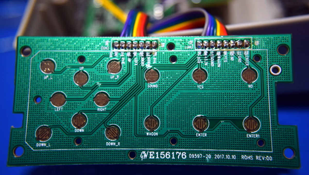

Keyboard
In what’s likely the most exiting bit of news, the keyboard on The Oregon Trail is exceptionally hackable. It’s a simple membrane keypad, and each wire is individually labeled for your convenience (on the keyboard and main board side). It’s ready to get soldered directly into the GPIO pins of your favorite microcontroller or SBC.
The biggest problem I see is the rather limited utility of the keys currently on the game. The directional pad (with diagonals) is nice, but not sure what kind of mileage you’ll really get out of a “Wagon” button. The best bet might be to repaint the keys, or go all out and 3D print new ones with whatever iconography works for your intended purposes.
Incidentally, remember that nostalgic sound I said the power button makes when you push it? Come to find out, the reason it sounds like a computer power switch is because that’s exactly what they used, complete with spring-assist. I’d recognize that little switch anywhere. I don’t know if that was an intentional little detail on the part of the designers, or just the easiest way for them to implement a hard power switch, but I’ll take it either way.
All told, the physical controls on The Oregon Trail should be very easy to implement into whatever project you might have in mind, and with a little cosmetic retouching of the keys, should make for a pretty slick setup.
