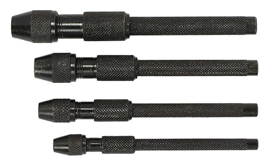

  1. Heat shrink works great for wrapping small bits so the chuck will grab. Its a little more permanent than tape, it keeps the shaft concentric because there is no overlap, and if you use a contrasting color it can make the really small ones easier to keep up with.
    1. “Pin Chucks” – a tiny drill bit with a round or hex shaft will be one of the better purchases you’ll make. Mine is probably fifty years old. You can use them as a hand drill by rotating them with your fingers, or chuck them into a crank/electric drill. Just a few dollars from the usual sources, or you can splurge on a Starrett but the cheap ones work just fine.
      https://images-na.ssl-images-amazon.com/images/I/719H9OpRiuL._SX522_.jpg
