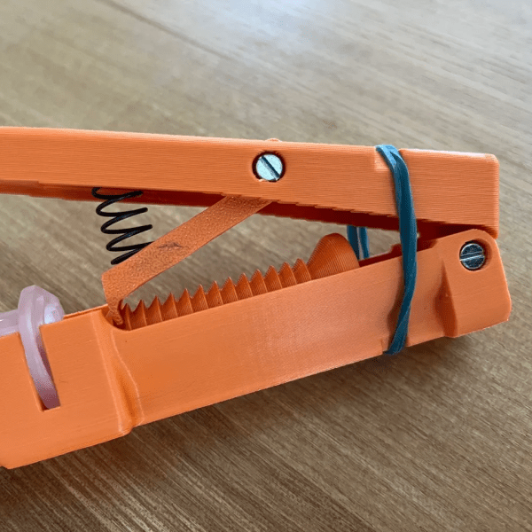

Syringes are pretty ergonomic, but when manually dispensing flux and solder paste it doesn’t take long before one wants a better way. [Elektroarzt]’s flux and solder paste dispenser design uses 3D-printed parts and minimal hardware (mostly M3x20 screws, and an optional spring) to improve handling and control.
The operating principle is very similar to how a hot glue gun feeds a stick of glue.
How does it work? The ratcheting lever mechanism is similar to that of a hot glue gun, where an arm slips into notches in a rod when pressed down, driving it forward and never backward. In the process, a larger lever movement is translated into a shorter plunger travel, enhancing control.
The types of syringes this tool is meant to be used with have a plunger tip or piston (the rubber stopper-looking part, in contact with the liquid) inside the loaded syringe, but no plunger shaft attached to it. This is common with syringes meant to be loaded into tools or machines, and [Elektroarzt]’s tool can be used with any such syringe in a 10 cc size.
It’s an attractive design, and we like the way syringes top-load as well as the way the tool is made to lay flat on a tabletop, with the lever pointed up.

  2. I’d have described the mechanism more as a caulk gun than hot glue gun based on the rest of the description.
    Either way great post and project. Now if I could just find some flux that didn’t expire between projects.
    1. Nicely done pieces.
      Agreed on the characterization, given the notched mechanism.
      I wonder if, with multiple notches on the pawl, if a finer feed resolution could be implemented.
      I have a “no drip”, (okay, it actually says “no-drir” which I assume to be a Chinglish translation) super fine resolution caulking gun with no notches, but that uses a sharp edge to bite into the metal rod. So, I wonder if a notchless, continuous feed like a glue gun could be implemented purely as a 3D print. I’ve made some close-ish tolerance press fit parts in PETG that do not want to come apart once pressed together.
      With big layer lines on the rod ratchet and pawl, maybe a really fine push mechanism could be made to work. I’d be happy with “almost completely” 3D printed”. Maybe just a long screw could work for the rod with the threads standing in for notches? Or not.

  3. I will use it, I have concerns over the strength of the plastic though
    In winters my “lab” drops to 14C (no heating or insulation) and hence the flux becomes less liquid, I have to push the plunger hard to get it out.
