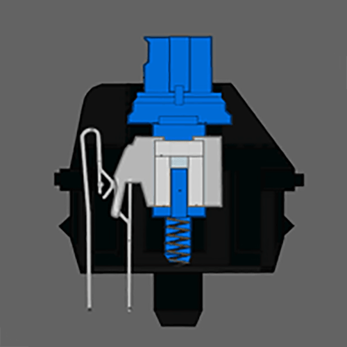

Mechanical switches are the next step up. These have a spring that pushes the key up, and the key presses two metal strips together, but in such a way that contact is made before the travel is complete, so it’s possible to ride the key on the edge and press more rapidly. Of course, when writing a Hackaday article, this doesn’t matter, but when destroying your enemies with rapid fire in the comments section of a Hackaday article, it’s critical. These kinds of switches are rated for 20-50 million keystrokes. The keyboards are also known for their click-iness, and are popular at home and extremely unpopular in open offices.
