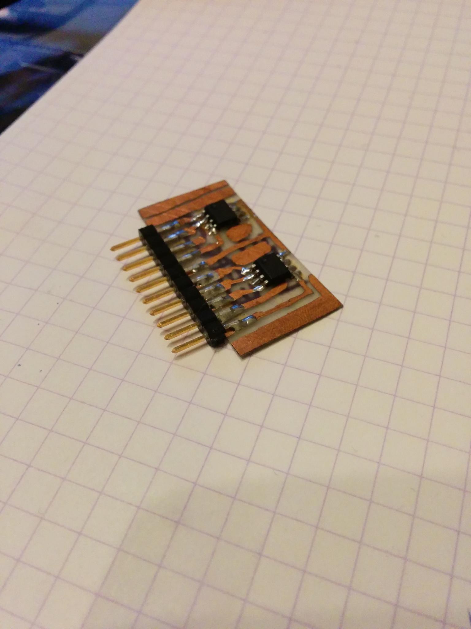

The idea of trying to prototype with SMD parts on the fly sounds like insanity, right? But then we watched [Leo Fernekes] walk calmly and carefully through his process (video, embedded below). Suddenly, SMD prototyping jumped onto our list of things to try soon.
[Leo] speaks from a lot of experience and tight client timelines, so this video is a fourteen-minute masterclass in using copper-clad board as a Manhattan-style scratch pad. He starts by making a renewable tool for scraping away copper by grinding down and shaping an old X-Acto blade into a kind of sharpened Swiss Army knife bottle opener shape. That alone is mind-blowing, but [Leo] keeps on going.
In these prototypes, he uses the through-hole version of whatever microcontroller is in the design. For everything else, he uses the exact SMT part that will end up on the PCB that someone else is busy designing in the meantime.
After laying the board out on paper, [Leo] carves out the islands of conductivity, beep-checks them for shorts, shines the whole thing with steel wool, and goes to town.
The tips and tricks keep coming as he makes jumps and joins ground planes with bare copper wire insulated with heat-proof Teflon tubing, and lays out the benefits of building up a stash of connectors and shelling out the money for a good crimp tool.
And why do you need a good crimp tool? Because when they’re done properly, crimped connections are stronger and more reliable than solder. There’s a lot more to them than you might think.

  6. An exacto ground the way indicated is very awkward to hold. In the jewelry trade they use a ‘graver’. Generally used with a palm handle. They’re only a few dollars. Much easier to hold and control than an exacto. I have an assortment in different widths from hairline to 100 mils or better. You can get the usual HSS which needs to be sharpened fairly often (easy using a Dremel or a stone). Or, you can get carbide which holds an edge much longer but needs a diamond stone or wheel to sharpen. Use a small wood block with a little ledge to hold your board and avoid stabbing yourself 100 times. Use carbon paper (What’s that?!!) to transfer lines onto the board. Or, draw with a sharpie.
    Beware of double-sided PCB. There’s typically 17 pF per square inch or 1.5 pF capacitance for a 250 mil square pad. You need to factor that into the circuit design and remove copper from the back (usually ground) where necessary. You can do vias to the back side and avoid flying jumpers. With care it’s possible to lift a corner of a large copper area and peel away the copper to remove larger areas. Faster and neater than scrubbing it off with a graver. I’ve been doing breadboards this way for many decades.
    1. Heat gun makes removing the back side copper about 20x easier. I use a hot air pencil. It peels off like a sticker on a banana.
      If you use a heavy xacto to put an incised line on the copper, you can then follow the line with the graver a lot more easily. I’d like something that’d cut two lines about 0.2mm apart because then I could peel off the 0.2mm and have a nice wide separation.
      At work I use an LPKF board plotter, and set the insulation width depending on the voltage, and peel off the intervening copper (or all the no-net copper, if capacitance is a problem) with a hot air pencil. The boards come out quite nicely, and it’s really helpful to our design people that we can go through four different board layouts/revisions per day until they get the one they like, and then we turn that one into a green board that’ll show up three days later. Sometimes we go through 10 or 20 revisions in that first few days, though.
      1. The heat trick also works well if you want to remove some pads of a proto board. Just put the iron on to heat the pad, and peel it off with the knife.
  7. i needed some small boards, but rather than wasting an entire $2 blue sheet on two small boards (like less than a square inch). so i broke out the diamond file kit and freehanded it much like this. i think the best takeaway here is the tool he created which is a lot cleaner than the triangular diamond file i usually use. im gonna go make one right now.
    1. Ah yeah, that’s one thing I’ve used, the ends of needle files. I’ve been trying to remember my “preferred tool” for this, but it seems like I use something different every time, since I don’t do it very often. Another couple of things are, broken hacksaw blades, holding so the teeth rake toward you and the last tooth on the end is more or less the same shape as his edge there. Then I’ve used drywall screws, which are always harder steel and stay pointy. Lately however, I’ve owned a dental pick with a reverse spadey end on it, and I score with whatever HD craft knife is at hand, or penknife, then rake it out with that. I’ve probably abused the pointy ends of scissors and side cutters at some time also.
      Drywall screws are probably pretty easy for the “no shop no worries” crowd to make a “circuit adze”* just get 4 to 6 inches of 3/4 to 1 1/4 round or square or whatever softwood or dowel or wooden broom handle and drive a drywall screw through it at an angle, near, but not too near the end, leaned toward the rest of the handle. (Make a number 7)
      * or make up an even fancier name for it, a discontinuity furrow insertion tool.
