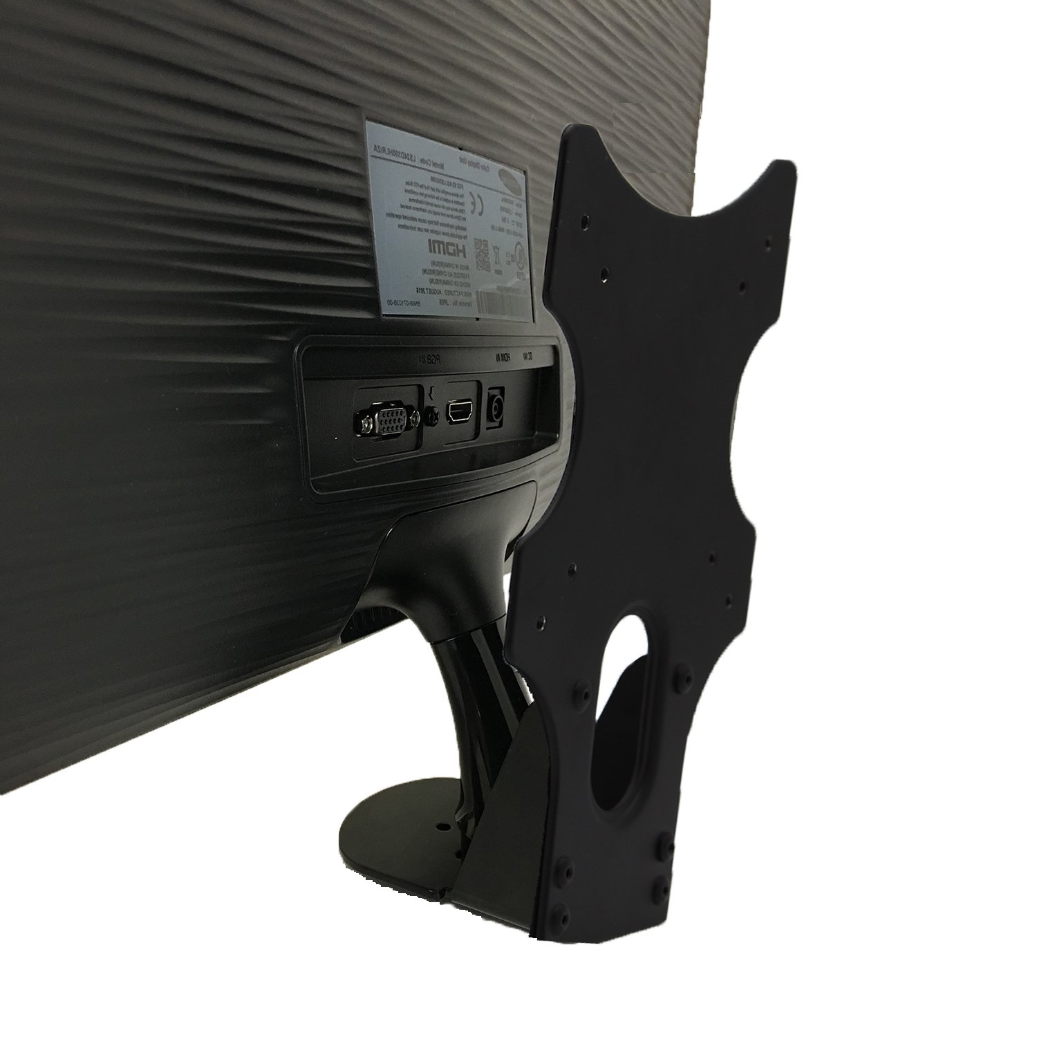

Some monitors lack the holes on the back that make them VESA-compliant, so mounting them on a monitor arm can be a non-starter. To handle this, [Patrick Hallek] designed and 3D printed these adapter arms to make flat monitors mount to VESA hardware whether they want to or not.
How does it work? When a monitor can’t attach directly to a VESA mount, this assembly attaches to the mount instead. The three arms extend around the edge of the monitor to grip it from the bottom and top. Some hex-head M5 bolts and nuts are all that are required to assemble the parts, and the top arm is adjustable to accommodate different sizes of monitor. As long as the screen size is between 17 and 27 inches diagonal, and the monitor thickness falls between 30 mm and 75 mm, it should fit.
It’s a smart design that leverages one of the strengths of 3D printing: that of creating specialized adapters or fixtures that would be troublesome to make by hand. That is not to say that there’s no other way to make exactly what one wants when it comes to mounting monitors: check out this triple-monitor setup using some common metal struts, no welding required.

  1. “When you have a hammer, everything looks like a nail”.
    I wouldn’t trust that plastic to support the weight long-term. Would not a couple of pieces of wood or aluminum have been a better choice? But, I suppose that lacks the “I am a clever hacker with a 3-D printer” cred.
    1. Depends on the plastic and printer configuration and software settings.
      Materials science often surprises people.
      Just like welding, sometimes the pretty welds are the shitty ones while the ugly blobs might actually have a surprising amount of penetration
    2. I really detest this sort of “but doing it this other way would be better!!!!” comment. Yeah, so what? I’m more interested in seeing people’s ideas, creativity and design choices than in cheap criticism. There’s *always* an easy way to tear down someone else’s work.
      Many monitors aren’t nearly heavy enough to cause a problem here. We’re not mounting CRTs after all.
      And this is a good way to make use of cheap old monitors that normally would just end up gathering dust.
    3. “I wouldn’t trust that plastic to support the weight long-term.”
      That depends on the weight of the monitor of course.
      But also it depends on what kind of plastic is used and which way the layer lines are run. I wouldn’t want the weight of the monitor constantly pulling the layers apart.

      1. Plastics don’t creep *that* much, unless they’re near the glass transition temperature or they’re right up against the knee of the stress-strain curve. You don’t leave a plastic doodad on the table and come back to find it’s spontaneously become a puddle of goo.
        1. Brackets like these have multiple points of stress concentration, and a monitor like that easily weighs a few pounds, and the lock bracket pieces acting as levers which makes it highly likely to creep and fall off one day in the not so distant future.
    1. Not from my limited printing experience. My parts tend to break pretty easy. Some are functional, if used with care, but most just don’t hold up all that well. I really would trust a monitor on printed parts. The arm I made for a small camera, is a little scary, but hasn’t broken yet. Very gentle when mounting and adjusting. Broke two pieces when I first assembled it, and learned it wasn’t very strong. GoPro mounts haven’t worked out well at all…

    When you hold a piece of plastic under constant strain, it will gradually re-align the polymers and lose the tension, which is why plastic springs don’t really work. Alternatively, if you keep a constant stress, the strain will keep growing and the plastic part sags.
    This happens fastest if you should ever get the plastic hot, so an errant sunbeam through the window can make your monitor fall onto the table.

  4. I thought PLA had a problem where any force that was constant over a long period of time would cause a break. So the solution was just not to use PLA. PLA kind of sucks anyway since it will go soft outside on a hot day or in a hot car, pretty much anywhere but inside an air conditioned house. So the solution was to use ABS.
    But, I printed up a couple of PLA brackets to hang an air filter from my printer enclosure. It probably has a couple of pounds of charcoal in it. This was supposed to be temporary. It’s been close to a year now probably. They were a little droopy from the start but don’t seem to have degraded at all. I can see brackets like these holding a monitor as long as it isn’t a particularly heavy one. And that’s just PLA!
    I think the trick is make sure the weight pulls parallel to the layer lines and not perpendicular.
    Oh, and if the sun is shining on your monitor mount hot enough to soften plasitc then it probably isn’t doing any favors to your monitor either.
    And for the real plastic haters in the comments here.. Your monitor’s cases are made from plastic themselves are they not?
    1. Plastic creep happens quickly at only slightly elevated temperatures.
      My monitors are made with an internal structure of steel, and non-load-bearing exterior shells of plastic.
      1. Well, for a while I was sticking an electric windshield defroster in my printer enclosure yet those brackets which I mentioned handled it just fine. And that was just PLA. I never did measure the temperature and I stopped doing that when I found that it was pulling enough current to make it’s own power wire warm. I’m pretty sure it was hotter than any of my monitors though.
        But that’s just PLA.
        I’ve had a PET-G Benchy sitting in my car all summer long, even on days that were near 100°F (~38°C). It hasn’t deformed a bit although admittedly there is no pressure on it. It has passed the fingernail test just fine though even on those 100° days.
        ABS handles even hotter temperatures. Much of a typical car’s interior is made of ABS. Does your monitor reach the temperature of a closed car on a hot summer day?
        And if this doesn’t convince you there’s always nylon.
        There are actually many different kinds of plastic and each has their own properties. It doesn’t really make a lot of sense to make blanket statements about them.
  5. CNC router, or laser, cut wood. Or heck, even scroll saw cut wood! 3D printing is too slow and WAY too expensive for these things that are fundamentally 2D shapes.
    3D printing has got to be one of the most overused and misused technologies of all time.
