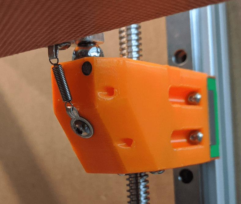

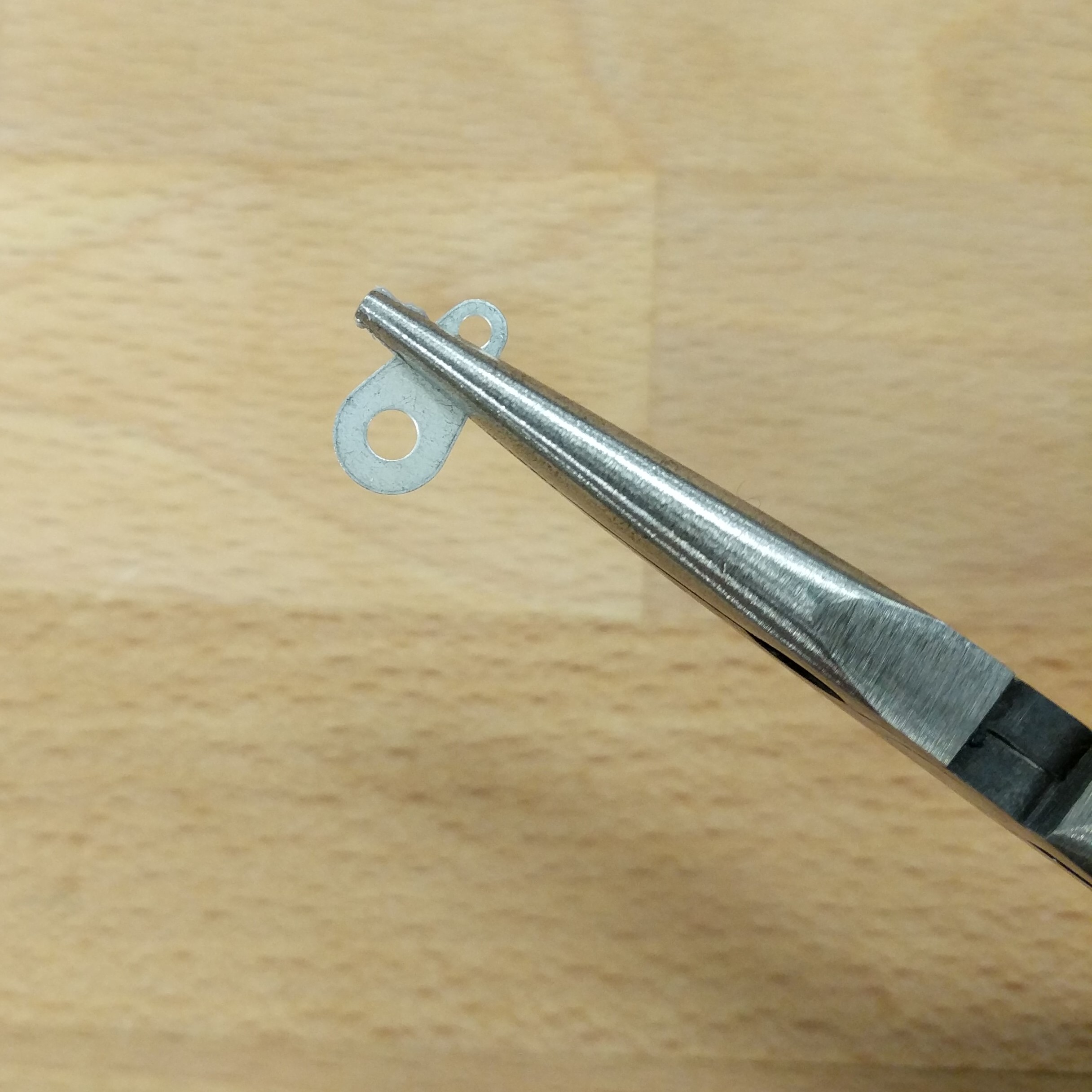

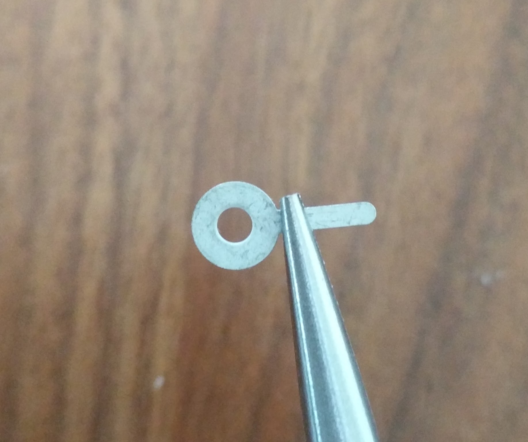

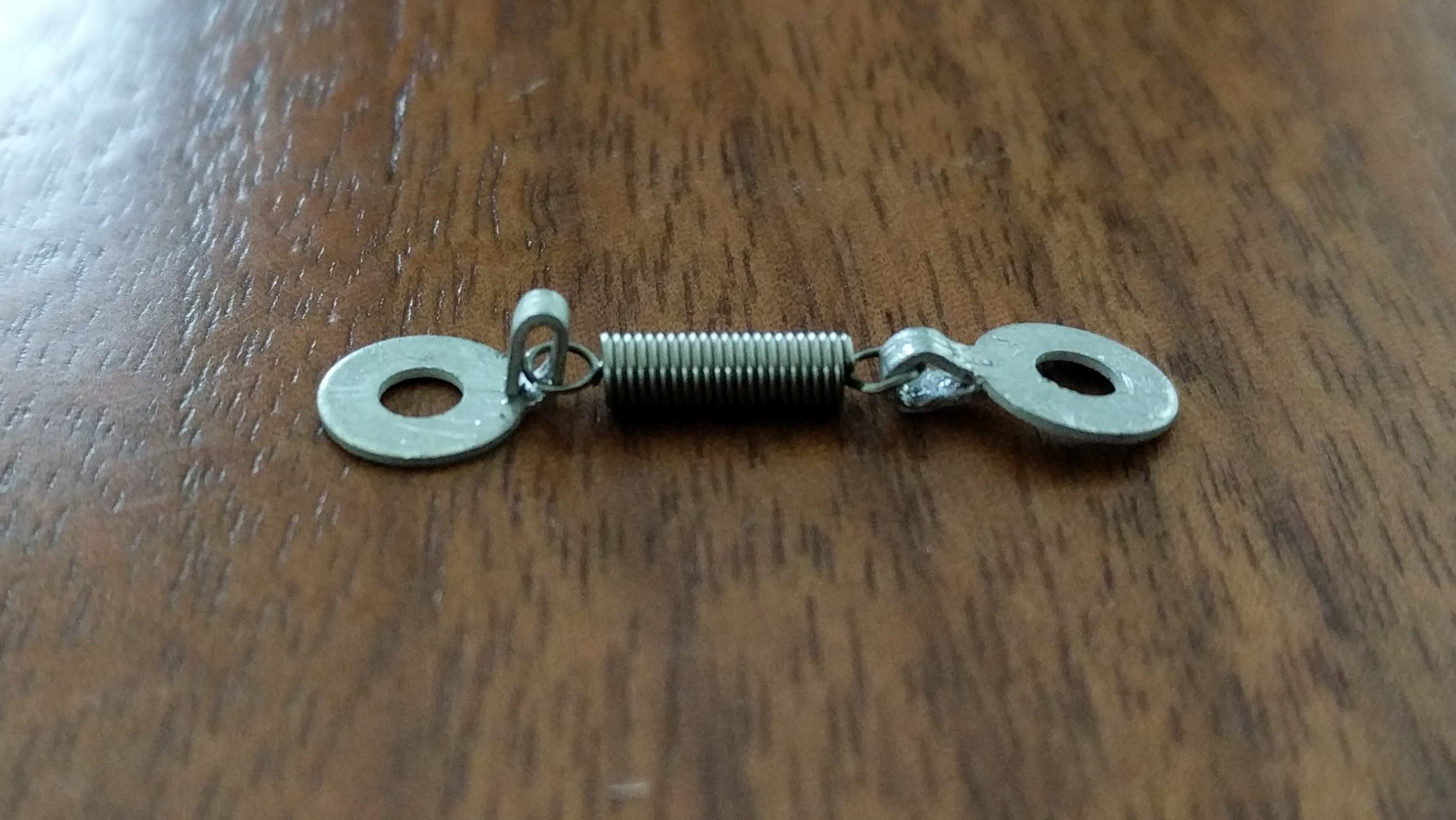

Now let’s transition to working with extension springs. These springs often arrive with loops on each end to make them easier to attach into their target application. But when it comes to hooking them into 3D printed or laser-cut plastic parts, attaching springs to small integrated plastic features risks them tearing out of the part.
One solution is a stock part called a spring hook or spring anchor. While large spring anchors tend to be prolific, small ones aren’t. Alas, in my original hunt for spring anchors, I could only turn up one Misumi part at the M3 scale I was looking for. And at $5 apiece, they’re exorbitantly more expensive than other stock parts in my fastener bucket. As for simply opting for a screw in this case, it turns out that they make inconvenient spring anchors for two reasons: (1) the head gets in the way of installing the spring and (2) they only work well if the extension spring can be installed perpendicular to the screw. Surely, I thought, there must be a cheaper solution in this pile of part catalogs.
And there was! The answer arrived in the form of solder terminal lugs. These are normally intended to be soldered into a wire at one end and screwed into an electrical terminal at the other. And at about 20 cents apiece, they’re also quite cheap. Best of all, since they’re made from brass, they can be formed with pliers into a shape that’s convenient for retaining the spring at a particular orientation. I’ve used both Keystone Electronics’ 7328 (Digikey) and 4000 (Digikey) parts to hole small extension springs in compact odd configurations each of which was gently “pliered” into a convenient orientation first.
