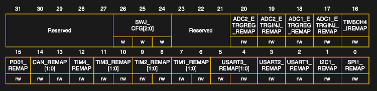

While there are a lot of positive things that could be said about the STM32F1 family of MCUs, their GPIO peripherals are not among these. The reason for this becomes once again apparent when looking at configuring AF mode on a GPIO pin. Say, we wish to configure AF mode on an STM32F103 MCU, first we look in its reference manual (RM0008) at section 9.3 (‘Alternate function I/O and debug configuration (AFIO)’) and zip over to section 9.3.8 (‘USART alternate function remapping’), pick our favorite USART’s table (USART1, table 54) and get:
STM32F103 USART remapping (RM0008 9.3.8, table 54).
No fancy layers upon layers of Alternate Function modes here, just a curt ‘either/or’ due to the limited muxing structure on the STM32F103. Doesn’t seem too bad, right? The fun part here is that the AF functionality is not fully integrated into the GPIO peripheral, but is found in the AFIO. Glancing over at section 9.4.2 we find the AFIO_MAPR (remap register), in which we are supposed to toggle the relevant entry (USART1_REMAP):
AFIO_MAPR on STM32F103 (RM0008 9.4.2).
While this may not seem much more involved than the modern STM32 approach, the annoying part here is that the AF modes are associated with the peripheral, instead of the GPIO pin. Instead of selecting an AF mode in GPIO_AFRH or GPIO_AFRL using the port, pin number and desired AF target, on the F1 MCUs you have to know the peripheral, as well as its entry position in AFIO_MAPR and what pin is associated with each of these entries and peripherals.
