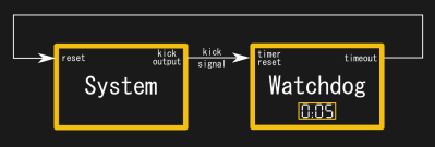

The concept of a watchdog timer is simple. When attached to a system and enabled, the watchdog timer starts counting down from a preset time. The embedded system or computer is then responsible for sending a “kick” signal to the watchdog at regular intervals. This resets the watchdog back to its maximum time value, and it begins counting down again. If the “kick” is not received before the watchdog timer reaches zero, the watchdog reboots the system.
A simple watchdog timer.
Getting the watchdog interval right is important. Set it too short, and a heavily-loaded system may fail to respond with a kick in time and an unnecessary reboot will be caused. Set it too long, and the system could be down for a significant period before the watchdog gets things up and running again. Careful analysis of the system and its proper behavior is needed to tune this appropriately.
It’s a handy way for dealing with crashes, kernel panics, and system hangs in a remote machine. Rather than having to send a technician out to hit the reset button, the machine can reboot itself when it gets stuck. Watchdog timers are crucial in applications where sending out a human could cost thousands of dollars, or even be impossible, such as in satellites and other space applications.
