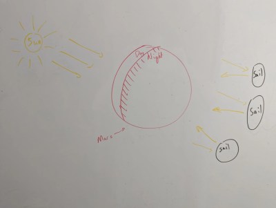

The concept is simple. By increasing the amount of sunlight falling on to Mars, its temperature can be increased significantly. That additional warmth would ideally release CO2 from cold storage in carbonate deposits already on  Mars. This would further accelerate warming just as it does on Earth via the Greenhouse effect. Ideally, pump enough heat in initially to get that CO2 into the atmosphere, and our favorite greenhouse gas might just do the rest.
To get more sunlight on Mars, Handmer proposes using solar sails. Not just one, or two, or a hundred, but solar sails in their billions. They would use light from the sun to travel from Earth to Mars on a timescale of months. When arriving at Mars, they would be stationed at the Sun-Mars L2 Lagrange point, where the required orbital corrections would be at a minimum. From that point, the solar cells would position themselves to reflect sunlight on to the Martian surface to provide heating.
The Martian atmosphere is made up of 95.32% carbon dioxide, 2.7% nitrogen, 1.6% argon, and just 0.13% oxygen. Atmospheric pressure is just 6.35 millibar, compared to 1013 millibar on Earth. That very thin atmosphere nonetheless gives Mars a nice tan sky.
The sun already provides energy on the level of roughly 600 watts per square meter on the Martian surface. That sums up to about 21,600 terawatts across the entire planet. Compare that to the 8 gigawatts or so put out by our largest nuclear reactor, and it’s easy to see the sun is providing a lot more energy than we could hope to achieve with any kind of operation on the Martian surface. Reflect more of that sun, and that number goes up nicely.
Large solar sails placed opposite the Sun and Mars could be used to increase the amount of solar radiation falling on the red planet. Credit: Casey Handmer
Handmer notes that a reflector covering 1,000 square meters would reflect 600 kW of sunlight towards Mars. 1,000 sails of this size would effectively add a square kilometer of surface to Mars’s existing cross-sectional area of 36,000,000 square kilometers. That’s not really a whole lot.

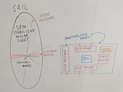

As mentioned above, the key is to scale into the billions. The idea is that these simple solar sails could be manufactured on the cheap. Handmer posits that a 1,000 gram sail craft could cover the aforementioned 1,000 square meters. He estimates a production cost on the order of $100, roughly equivalent to a modern cellphone. For electronics, the sail would need a processor, a telemetry radio, a small solar panel, and a camera to act as a star tracker for navigation. It would then use LCD panels to act as reflectively-variable elements to change its direction under the influence of the sun. At that weight, launch costs would be around $2000. Add that on to the manufacturing cost, and you’ve got 1,000 square meters of Mars reflector for just $2100. Advances could shave manufacturing costs and weight down further, slashing launch costs which are heavily weight dependent.
After launching cheap solar sails high enough into Earth orbit, they would use light pressure from the sun to make their way to the Sun-Mars L2 point. Handmer believes such craft could be built as cheaply as $100 in grand numbers. Credit: Casey Handmer
If these solar sails could be manufactured with the same efficiency we churn out smartphones, we could churn out hundreds of millions of these craft in a few years. Handmer suggests a decade of launches could net 1.5 billion sails in position around Mars, which would be good enough for increasing energy input to the planet by 4%. In turn, Mars’ thermal radiation would have to increase by 4% to balance this extra energy input, which suggests its basic temperature would rise from 210 K to 212 K—or roughly -61.15 Celsius.  He costs all this out at around $10 billion, which sounds awfully cheap in the grand scheme of things.

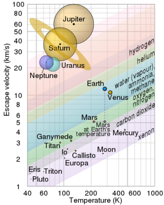

The higher escape velocity of heavier planets allows them to hold on to an atmosphere more easily. Lower temperatures are a boost, too. If we warmed Mars to Earth’s temperature, it’s atmosphere would lose oxygen and nitrogen more quickly than it already does.  We could end up giving Mars an atmosphere only to lose it in short order. Credit: Cmglee, CC BY-SA 3.0

The plan also glosses over some finer points of the engineering required. It’s one thing to build 1.5 billion solar sails, and another thing entirely to launch them all and get them to Mars. Once there, they’d need to be very well organized to avoid crashing into each other and turning into one big tangled blob in orbit.
