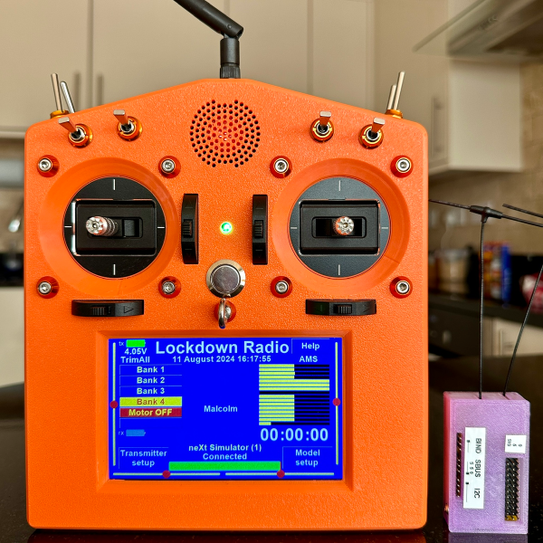

Apparently, that’s what [Malcolm Messiter] was thinking when, during the COVID lockdowns, he started his own RC project that he’s calling LockDownRadioControl. The result covers the entire stack, from the protocol to the transmitter and receiver hardware, even to the software that runs it all. The 3D-printed remote sports a Teensy 4.1 and off-the-shelf radio modules on the inside, and premium FrSky hardware on the outside. He’s even got an extensive folder of sound effects that the controller can play to alert you. It’s very complete. Heck, the transmitter even has a game of Pong implemented so that you can keep yourself amused when it’s too rainy to go flying.

  2. What’s the RF performance like?
    I’m really surprised it’s not using ELRS radios. I doubt an nRF24L01 will work anywhere near as well as ELRS.
    1. The ML01DP5 and ML01SP4 from EByte are rather special versions of the nRF24L01+ with a >2 km range. My system sends 200 packets per second, so even if a few are lost to interference the number that actually get to the RX per second usually vastly exceeds what commercial sets achieve.
