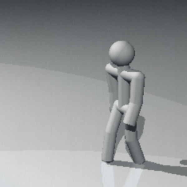

The ersatz computer has a lot of messages in Spanish, but you can probably muddle through if you don’t hablar español. We did get the ray tracing example to work, but it was fairly slow.
