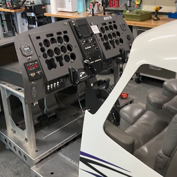

[Jared] managed to find a professional FAA-certified flight simulator at an auction (a disassembled, partial one anyway) and wondered, what would it take to rebuild it into the coolest flight sim rig ever?
In a video, [Jared] gives a tour of the system and highlights the potential as well as pointing out challenges and drawbacks. Fortunately the system is of a modular design overall, and the motion control system is documented. The chassis and physical parts are great, but the avionics stack is a mixed bag with some missing parts and evidence of previous tinkering — that part being not quite so well documented.
Conceptually, a mid-tier gaming rig with a wraparound display will take care of the flight software part, and some custom electronics work (and probably a Raspberry Pi or three) will do for interfacing to various hardware elements. But a lot of details will need to be worked out in order to turn the pile of components into an entertaining flight sim rig, so [Jared] invites anyone who is interested to join him in collaborating on innovative approaches to the myriad little challenges this build presents.

  4. “A professional FAA certified flight simulator” ?
    This is very – “disingenous”. Perhaps at one time it was certified as a CPT FTD, but in it’s current state, it’s more of a has been arcade game – and that’s all it ever will be – “full stop”.
    A “professional FAA certified flight simulator” is under FAA 14 CFR Part 60.
    QTG’s describe the criteria for certification.
    A Level D sim (on a full 6 DOF motion base), the cockpit uses actual flight hardware. So the PFD’s, MFD’s, LRU’s, etc are the real boxes (translation: very expensive), that are fed simulated data from the custom software driving the simulation via the industry standard data bus (ie. ARINC-429)
    The home built rigs are more for entertainment.
    The’d never pass muster to be issued an actual FAA serial number as a training device.

  6. What’s that “PuSH Inc” company shown on the PCB’s at around 09:00? Maybe they are willing to share some info or sell spare modules.
    It also seems there are regular PIC uC’s on those boards, so even worst case, you don’t have to replace them, but can just reprogram the uC’s. Those PCB’s are surprisingly empty (I.e, easy to reverse engineer). I would expect some kind of bus protocol with packets. I would have expected RS485 or CAN drivers on a project of this caliber. Without extra hardware, the protocol is pretty much SPI, I2C, UART, or some bit banged TTL thing. Maybe a bit of LIN, or something else with open drain?
    1. PuSH Inc is apparently: https://pushei.com/
      It seems to be “just” a PCB factory (With PnP) but I don’t see a hint of software engineering or even PCB design on their website. But it does make me wonder why their name is so prominent on the PCB’s.
