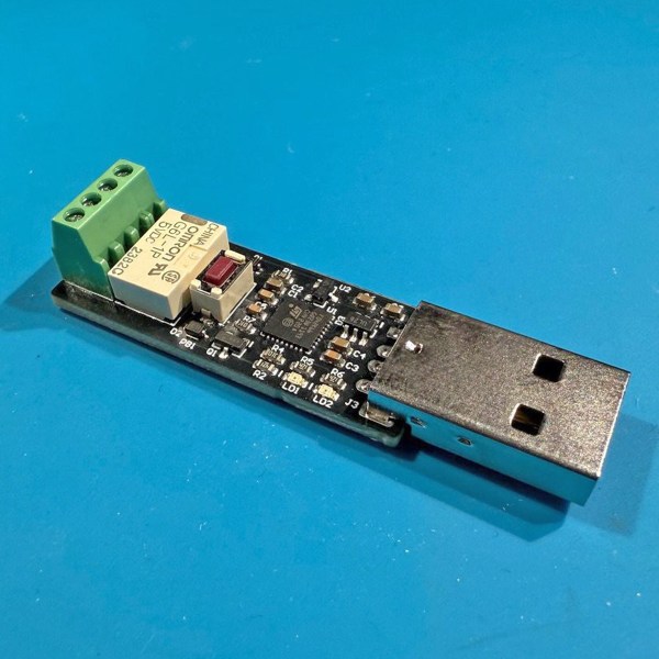

Meet the little board that could: [alcor6502]’s tiny USB relay controller, now evolved into a multifunction marvel. Originally built as a simple USB relay to probe the boundaries of JLCPCB’s production chops, it has become a compact utility belt for any hacker’s desk drawer. Not only has [alcor6502] actually built the thing, he even provided instructions. If you happened to be at Hackaday in Berlin, you now might even own one, as he handed out twenty of them during his visit. If not, read on and build it yourself.
This thing is not just a relay, and that is what makes it special. Depending on a few solder bridges and minimal components, it shape-shifts into six different tools: a fan controller (both 3- and 4-pin!), servo driver, UART interface, and of course, the classic relay. It even swaps out a crystal oscillator for USB self-sync using STM32F042‘s internal RC – no quartz, less cost, same precision. A dual-purpose BOOT0 button lets you flash firmware and toggle outputs, depending on timing. Clever reuse, just like our mothers taught us.
It’s the kind of design that makes you want to tinker again. Fewer parts. More function. And that little smile when it just works. If this kind of clever compactness excites you too, read [alcor6502]’s build log and instructions here.
I wouldn’t call it multifunction device so much as call it multipurpose PCB. The reason being that in order to switch between functions, you must bridge or remove a particular set of components. Unless you like soldering really small things a lot, you’re not going to be switching between functions but rather have multiple PCBs that are built to act as different devices.

I see what you mean after I studied the underside of the PCB. Yeah shorting solder pads to achieve a certain function makes it single use, unless you care to fire up the good old solder iron and desoldering pump.

Coil Resistance: 139 Ohms
Sorry, (mech engineer here) But how do actually program/use it?
USB Command Interface
The firmware uses USB CDC (Virtual COM Port) to communicate via serial commands; accepts structured ASCII commands (easy to use in Bash, Shell and Serial Terminal).
Example Commands (Send via Terminal/Script)
Command Function
#S1! Switch ON relay
#P3! Pulse relay for 300ms
#F90! Fan at 90% PWM
#W40! Load controlled with a PWM signal at 40% (B4 or B5 Closed)
#A75! Servo motor positioned at 0°
#Z15000! Set the PWM frequency at 15 KHz
#I! Transmit on the USB the input pin state
#T! Transmit on the USB the fan RPM
#O! Transmit on the USB the PWM percentage of the output
