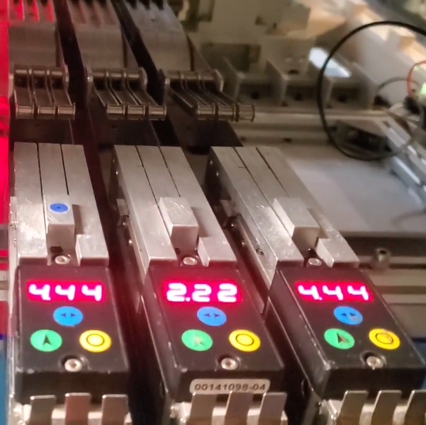

[Chris Cecil] had a problem. He had a Manncorp/Autotronik MC384V2 pick and place, and needed more feeders. The company was reluctant to support an older machine and wanted over $32,000 to supply [Chris] with more feeders. He contemplated the expenditure… but then came across another project which gave him pause. Could he make Siemens feeders work with his machine?
It’s one of those “standing on the shoulders of giants” stories, with [Chris] building on the work from [Bilsef] and the OpenPNP project. He came across SchultzController, which could be used to work with Siemens Siplace feeders for pick-and-place machines. They were never supposed to work with his Manncorp machine, but it seemed possible to knit them together in some kind of unholy production-focused marriage. [Chris] explains how he hooked up the Manncorp hardware to a Smoothieboard and then Bilsef’s controller boards to get everything working, along with all the nitty gritty details on the software hacks required to get everything playing nice.
For an investment of just $2,500, [Chris] has been able to massively expand the number of feeders on his machine. Now, he’s got his pick and place building more Smoothieboards faster than ever, with less manual work on his part.

    1. Labor cost…hard to calculate. If I would have financed the feeders outright…probably could have saved myself some time.
      But I was doing a lot at the same time including moving locations so…the downtime wasn’t a big deal.
      Plus, I can do this 2 more times on the machine if I want. It can have up to 128 feeders total.
      The amount of knowledge and confidence I gained with the overall use/design of the machine can’t really be measured though.
      Hopefully…some other people with the same issue will learn from what I did.

        1. Exactly…very hard to calculate. There was a lot of other things involved that a normal company would have no problem writing off as “training”. Anyone who has ever gone through the ESD or IPC classes when in industry can attest to that. There is a lot spent on teaching people to do the job faster/better.
          This mod saved me 30min/board of hand placing 0402 under a microscope. Pretty easy to make up a “$/board” number…but it is harder to create a number for how absolutely soul killing it is to do that work by hand when you know a machine is sitting next to you that can do it in 5min.
          Even at $32k…it likely would have been worth the money…but I would have learned a lot less (plus, had less to share with the community).

    1. I am not using the shutters on mine right now either. The Manncorp sends the advance signal just after a pick…so it is kinda useless for planning the shutter timing.
      In the process of going through the feeders and fixing/cleaning/lubricating them I managed to make the shutters work a lot better…but again it is a bit useless.
      Couple videos I did of the teardowns. I am planning one that goes over a full cleaning/lubrication but I haven’t got to it yet. https://youtu.be/2ejQfJDqQio?si=z7DteAWf4AW_a-SF https://youtube.com/shorts/cyOQEQYz0To?si=8KFYFTAZQyngKD-O
      Second video shows the advance mechanism which I think is interesting.
      I may take the magnets off your hands though because I can certainly find a use for them in other projects :) They are kinda neat.
