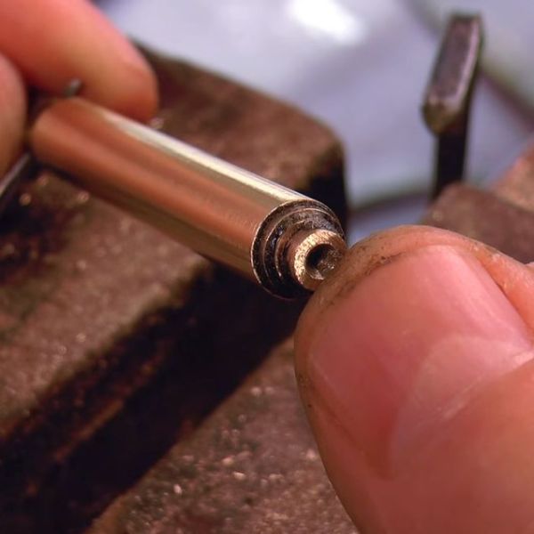

It’s human nature to look at the technological achievements of the ancients — you know, anything before the 1990s — and marvel at how they were able to achieve precision results in such benighted times. How could anyone create a complicated mechanism without the aid of CNC machining and computer-aided design tools? Clearly, it was aliens.
Or, as [Chris] from Click Spring demonstrates by creating precision nesting thin-wall tubing, it was human beings running the same wetware as what’s running between our ears but with a lot more patience and ingenuity. It’s part of his series of experiments into how the craftsmen of antiquity made complicated devices like the Antikythera mechanism with simple tools. He starts by cleaning up roughly wrought brass rods on his hand-powered lathe, followed by drilling and reaming to create three tubes with incremental precision bores. He then creates matching pistons for each tube, with an almost gas-tight enough fit right off the lathe.
Getting the piston fit to true gas-tight precision came next, by lapping with a jeweler’s rouge made from iron swarf recovered from the bench. Allowed to rust and ground to a paste using a mortar and pestle, the red iron oxide mixed with olive oil made a dandy fine abrasive, perfect for polishing the metal to a high gloss finish. Making the set of tubes concentric required truing up the bores on the lathe, starting with the inner-most tube and adding the next-largest tube once the outer diameter was lapped to spec.
Easy? Not by a long shot! It looks like a tedious job that we suspect was given to the apprentice while the master worked on more interesting chores. But clearly, it was possible to achieve precision challenging today’s most exacting needs with nothing but the simplest tools and plenty of skill.

I guess I need to watch the video, but I can’t figure out how he made the fit of one tube in another tighter by abrading away material from either one. If the hole was undersized, or the inner one oversized, then I could see it, but if they’re already a sliding fit, they could only get looser if material is removed from either one. What am I missing?
I see what you’re saying. It’s not addressed in the video, but if it was me, maybe only lap the parts when the inner part is cool, and the outer part is hot.
It didn’t explain it. He put one tube inside another and then twisted it with the lapping compound in between – but that should have resulted in a looser fit, not a tighter fit. Something is missing here.
I was also wondering about this. I was thinking maybe the material is being moved from the high spots to the low spots? But I don’t really know a lot about how lapping works.
He mentions that the fit before lapping was light interference fit — this would mean the hole was very slightly smaller than the inner tube, and a fair amount of force would have been needed to get one tube inside the other. This wasn’t really apparent on camera though — I imagine he could feel it though.
The sliding fit he mentioned would have been the end goal of the lapping. It would have been gas tight initially — the air piston demonstration after lapping is showing that movement is now free, while still being a decent pneumatic fit.
If it was an interference fit, then you couldn’t get the tubes inside one another to lap them, because the lapping compound wouldn’t fit in between. It still doesn’t make any sense.
What’s more likely is that there were two or more sets of tubes made, and they were mixed and matched until pairs were found that could be lapped smaller or looser to fit each other perfectly, using the loosely fitting remaining tubes as sacrificial lapping tools.
Or, the third alternative is that the video is a cheat: the pneumatic action is accomplished with oil in between the parts.
The method is very similar to what Stephan Gotteswinter uses. First ream a hole, then put it over a mandrell, and then grind the outside concentric with the already finished hole, as seen in:
https://www.youtube.com/watch?v=_rjjZfnK-m4
Main difference is that Stephan does it to earn sandwiches by selling the product, and not for researching archeological methods. But overall, the difference is quite small.
I am one of his Patrons. When he dropped the video to us about two weeks ago, I wrote to Clickspring and asked him. He dropped it publicly 25 April 2025 about 1800 UTC.
He told me that this is exactly how he did it ie made the hole and then turned the outer walls to be concentric
Wait how does he achieve a gas tight seal by starting with something that has enough of a gap between the two surfaces that he can fit the jewelers rouge in between them. Then using that to grind out more material and somehow making the fit TIGHTER? I’m so confused.
He mentions it’s a light interference fit to start with. The metal is being elastically deformed when one tube is inserted in the other. Also the particles are harder than the metal, so they can embed in the surface and elastically deform it. Likely it was gas tight to start with, but certainly not free moving.
That sliding fit he’s showing in the end implies some clearance between the parts, probably on the order of 50 microns or so. This is enough to produce the gas piston effect shown when the parts are in motion.
That size is likely quite a bit larger than the rust particles in question.
The end result of the lapping was to eliminate most of the sliding friction, but precisely enough that the seal was maintained.
A “light interference fit” would squeeze the lapping compound out when you force the tubes into one another, and even a light interference fit would bind them so you can’t turn them, so lapping wouldn’t be possible.
What’s more likely is that they had a “transition” fit where the inner tube is technically only slightly smaller, but you get some high and low spots that interfere. If you add the lapping compound and start working the parts together, it evens out and you get a pretty tight clearance fit. Possibly even a pneumatic fit.
That would make sense, but he shows the tubes fitting into one another first and then being lapped. That requires that there is already a fairly loose clearance fit because the high and low spots left by drilling and turning pass each other just fine. Lapping it even makes the clearance even bigger. That may still be fine for a bearing, but would not make a pneumatic fit.
A drop of oil or water however would seal it right up, making the appearance of a pneumatic fit even if it wasn’t.
