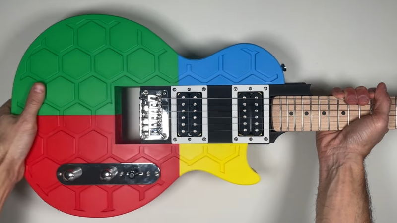

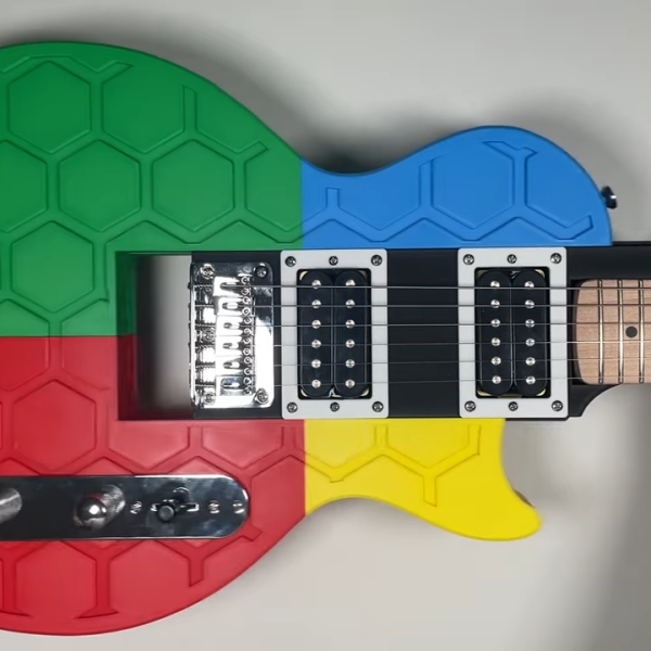

Got some spare filament and looking to build a guitar you can truly call your own? [The 3D Print Zone] has created a modular 3D printable guitar system that lets you easily mix and match different components for the ultimate in customization.
The build is based around a central core, which combines the pickups, bridge, and neck into one solid unit. This is really the heart of the guitar, containing all the pieces that need to be in precise alignment to get those strings vibrating precisely in tune. The core then mounts to a printed outer body via mating slots and rails, which in the main demo is made to look like a Les Paul-style design. This outer body also hosts the volume, tone, and pickup controls. Output from the pickups travels to the controls in the outer body via a set of metallic contacts.
What’s cool about this build is that the sky really is the limit for your creativity. As the video below demonstrates, the main build looks like a Les Paul. But, armed with the right CAD software, you can really make a guitar that looks like whatever you want, while the 3D printer does all the hard work of making it a reality. The files to print the guitar, along with the pickups and other components, are available as kits—but there’s also nothing stopping you from working up your own printed guitar design from scratch, either.

In no universe is this either a Les Paul, Telecaster or any other style guitar. Because, and here’s the kicker Danno, the neck doesn’t change. The pickups are too close together so the bridge pickup and the actual bridge need to move tailward, i.e. away from the neck and neck pickup.
One common thread is all the illustrations show a Telecaster style pickup selector, volume and tone plate. And a crap neck, more on that later. HaD always says “after the break” but there is no break! Show me break! So still not a Les Paul, more a Less Paul, amirite? I really have trouble getting past the pickup disaster.
Where is the sustain? Show me sustain! Might as well build the body out of styrofoam(spelling?). But wait what’s this? The kit includes A DOWEL and Super Glue? Heck, African American! That’s all you had to say!
Narrator flaunts like it’s modular but once Super Glue enters the chat ain’ nothin’ modula’ no mo’. I’d sooner buy an aftermarket neck, pickups, wiring harness and hardware and handcarve the various handcarved bodies out of hobos. Oh, don’t fret, we call driftwood “hobos” in these parts. Auto parts are another good resource.
The concept is good, the body material and just about everything else is less so.
