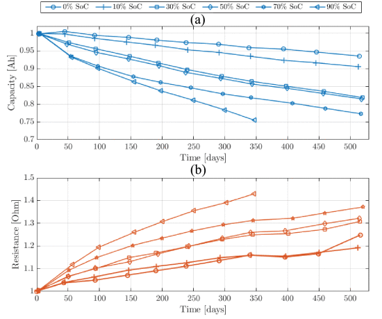

There are multiple ways in which each type of aging can occur, with most requiring the cell to be charged and discharged, as this inflicts mechanical and other types of stress. When it comes to storing LIBs, we enter the territory of calendar aging. This has an irreversible and reversible component, the former being impacted by three components: the state of charge (SoC), temperature, and time.
Calendar aging of NMC Li-ion cells at 50 ℃ and at various SoCs. (Credit: Wiljan Vermeer, IEEE, 2021)
What this tells us is that although you can affect LIB calendar aging, it’s a pretty inevitable aspect of their chemistry. This is true even in the case of the lithium-polymer (LiPo) LIB type batteries with its polymer electrolyte. This effectively means that charging the battery in a device to 80% instead of 100% will give it some more life, but you’d have to drop down to 50% or less to see the big gains. It’s also highly advisable to keep the battery relatively cool, which is where fast-charging is a terrible idea, especially as the resistance of the battery goes up due to aging.
While the exact mechanisms behind calendar aging are still being investigated, it’s likely that the layer that forms at the electrochemically unstable electrolyte-electrode interface (SEI) restructures to prevent the transfer of lithium ions, effectively increasing the measured resistance via the CL aging path.
In addition to calendar aging you have the charge-discharge cycle-based aging mechanisms, which not only affects the SEI, but also causes mechanical expansion of the graphite anode material, which leads to both the LLI and LAM aging paths. When you then add in the typical charging method for gadgets like smartphones using a LIB-based powerbank, you end up with double the charge-discharge cycles over simply slotting in a fresh battery.

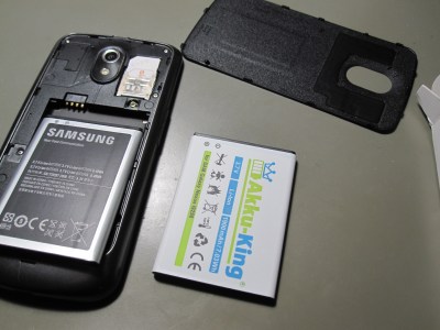

Replacing the battery in the Samsung Galaxy Nexus. (Credit: Maya Posch)
Beyond larger electronic devices, pouch cell LIBs are now integrated in countless more gadgets, from lamps to Bluetooth speakers. To address the sheer volume of these built-in LIBs, the EU’s Battery Regulation will begin to enforce its removability and replaceability requirements starting on 18 February of 2027.

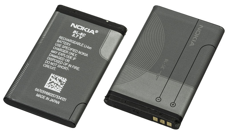

The Nokia BL-5C Lithium-Ion battery, this one from a Nokia N-Gage. (Credit: Evan-Amos)
While the BL-5C is still fairly large, at 53 mm x 34 mm and a thickness of 6 mm, point and shoot cameras as well as action cameras feature a range of smaller batteries, with the Canon NB-4L as used in the IXUS point and shoot cameras providing more than 750 mAh in a 35 mm x 40 mm package and a similar 5.9 mm thickness. The third-party replacements that I got of the NB-4L claim to provide 1,200 mAh, as modern LIBs tend to have more capacity within the same form factor due to more refined manufacturing.
Interestingly, even rechargeable AA-sized cells aren’t limited to NiMH chemistry any more, with Li-ion options now available yet still providing the 1.5 V one would expect. This does require a bit of electronics in the cell, and results in them having a capacity that’s similar to that of NiMH AA cells, while suffering all the aging issues of any other LIB in addition to the limited number of charge cycles. Assuming that the 1.2 V of NiMH cells is acceptable, then devices could accept AA or AAA NiMH cells.
