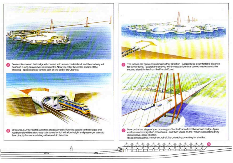

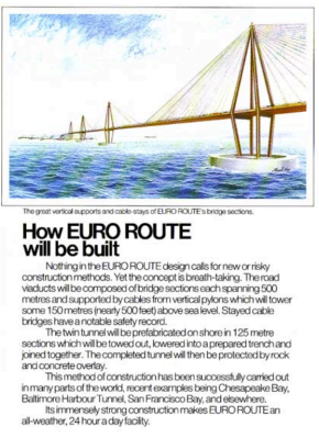

The Channel Tunnel might have been the winning project, but it wasn’t the only proposal on the table. The Euro Route project was an altogether bolder scheme. Their plan called for a three-stage crossing combining both road and rail. Cars would travel via a spectacular road link featuring bridges springing from each coast, leading into an immersed tunnel running through the deepest section of the Channel. Meanwhile, there would also be a twin-track rail tunnel not dissimilar from the Channel Tunnel itself.

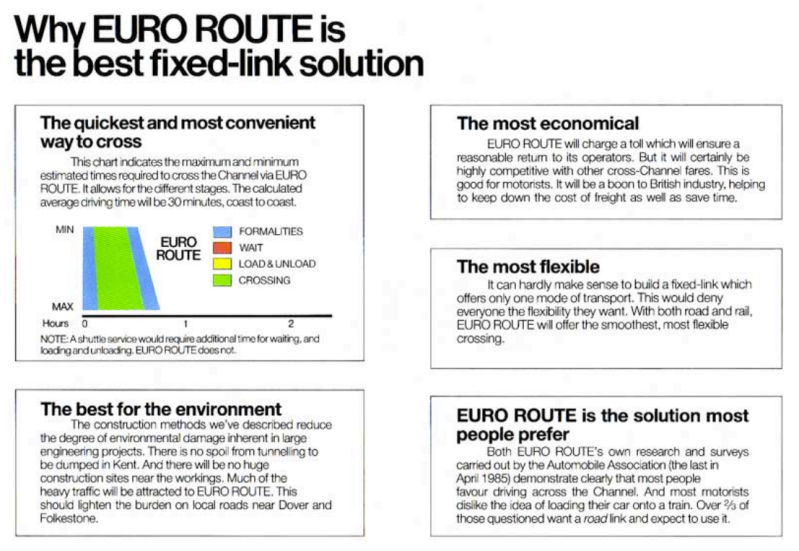

The Euro Route project was marketed based on its key offering—users would be able to drive all the way with a minimum of fuss. “From your home you will drive straight to France,” read the marketing materials. There would be no fussy loading and unloading of automobiles on to train cars. Meanwhile, those that wished to travel by rail could equally do so via the separate rail tunnel, with freight trains using the passage as well.
The project would not be cheap. Estimates were that it would cost some £6 billion to build (1985 prices). At the time, this figure came in at two to three times what the Channel Tunnel proposal was expected to cost—no surprise given it also involved an entire road crossing in addition to a rail tunnel. However, the project was backed by a consortium of heavyweight British institutions—including British Steel, Barclays Bank, and GEC—which had together secured over seven billion pounds in funding for the project. The intention was that it would be paid for in time by charging tolls to access the crossing.
The road crossing was designed for drama and practicality in equal measure. Motorists would leave the M20 near Dover, before passing through toll booths to pay for the journey. From there, they would make their way onto a bridge standing some fifty meters above the waves. This cable-stayed bridge would stretch for 8.5 km to an artificial island, where the motorway would spiral down beneath sea level to the undersea tunnel below. This tunnel consisted of a 21 km immersed tube tunnel carrying parallel dual carriageways safely beneath the shipping lanes, emerging at a second artificial island before another bridge carried traffic the final 7.5 km to France. A third artificial island would also sit in between the other two, serving as a ventilation shaft for the road tunnel and acting as a marker to enforce lane discipline for shipping in the Channel.

All in all, traveling the Euro Route was expected to take just 30 minutes over the road. Customs formalities were to be “speeded up by computer” to ease the journey, pushing the total time to approximately 45 minutes. This was to be a key advantage over concepts like the all-rail Channel Tunnel. “NOTE: A shuttle service would require additional time for waiting, and loading and unloading; Euro Route does not,” noted the marketing materials. . Those behind the EuroRoute believed people wanted to drive across the Channel themselves, rather than sitting in their cars on a train for a longer period of time.
The combined bridge-tunnel-bridge concept was, at first blush, more complicated than simply building a single long road tunnel from coast to coast. However, such a tunnel would have likely measured well over 30 km in length. This was considered somewhat undesirable both for the length of time spent underground and the build-up of traffic emissions. The open-air bridges were used to help break up the journey so less time would be spent in a tube beneath the waves. This design also created opportunity, for the artificial islands weren’t seen as just entry and exit points to the tunnel below. EuroRoute envisioned them as destinations in their own right, with refuelling, refreshment, and parking facilities, as well as other niceties like hotels and duty-free shopping complexes.

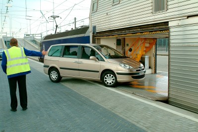

As built, traversing the Channel Tunnel via automobile requires a lengthy loading and unloading process, since the cars are hauled by train. Credit: Ministère des Affaires Étrangères Français

The Euro Route proposal noted that public sentiment was on its side. Contemporary research suggested that fifty-two percent of people preferred driving across, with many actively disliking the car shuttle concept. Yet when decision time came, the governments chose the Channel Tunnel—ultimately the simpler, cheaper rail-only proposal. The fact that the Channel Tunnel project would end up with massive budget overruns and significant delays perhaps casts that decision in a different light. At the same time, we might never know how well—or how badly—construction of the Euro Route might have gone.
