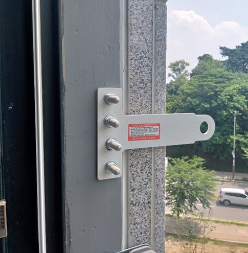

Key to these devices is their focus on simplicity. The descent control mechanism uses a geared braking system that automatically limit the speed of descent to 1.5 meters/sec or less, preventing the user from descending too quickly even if they panic and release their grip. The lifelines are also sold in a range of different lengths to suit the heights of individual floors in a building. This is important to ensure that as the user hits the ground, the other end of the rope has carried the other harness back up to the floor for the next user. The longest variants typically sold are 45 meters in length, intended for buildings up to 15 stories tall. Limits of practicality mean that while these lifelines are useful for many buildings, they’re perhaps not applicable to taller skyscrapers where such escape would be more difficult.
The engineering challenge here isn’t just mechanical. Automatic rope descent systems are a well understood technology, as are hooks and brackets rated to carry human weight for climbing or otherwise. The real challenge comes down to human factors—in that these systems need to be something people can figure out how to use under conditions of extreme stress. The devices need to be intuitive enough that someone who has never used one before can figure it out while a fire rages behind them. It’s one thing to learn how to use a rope descent system by watching a video and trying the equipment at a calm training session. It’s another thing entirely to do so while a fire rages in the hotel hallway behind you.
