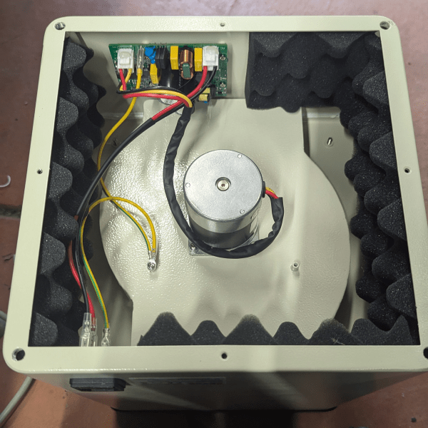

Why is there hot-snot on the power connector and the connector to the motor? Don’t these kind of connectors already have some form of locking of themselves?
Yes, they are latching connectors. Maybe they don’t latch very well. I’m sure you could come up with a reasonable explanation by yourself without having to ask the whole world.
It’s a conspiracy by “Big Hot Glue”.
Yeah they latch, and yeah they’re a bit crap. It’s pretty easy during assembly to bump them and they come loose (and arc), or even vibrate out in shipping. Happens more than you think.
It’s a very very common technique that doesn’t cost much. If you’re going to glue down caps & coils you might as well hit the connectors as well. Occasionally you see silicone used.
You note there’s no hot snot on the spade connector. That’s because as it’s an earth lead it’ll be a latching version, and they’re essentially impossible to remove (even with brute force & swearing), even more-so here where you can’t get at the locking tab easily.
(I did wonder why it was used, using a 4 pin connector there would be better than using 2 x 3 connectors which you might mix up. Was thinking BOM considerations before noticing the green side of the yellow wire.)

I wouldn’t want to see the inside of that box in a few years, all that crumbling foam which seems to go faster in electrical spaces. Some organs loved to use that stuff allover to silence buzzing from bass coating cables with sticky tape versions creating a hell of a de-con mess. If found early it just crumbles off into a vacuum nozzle with a stiff brush, later it’s the goo from hell.
