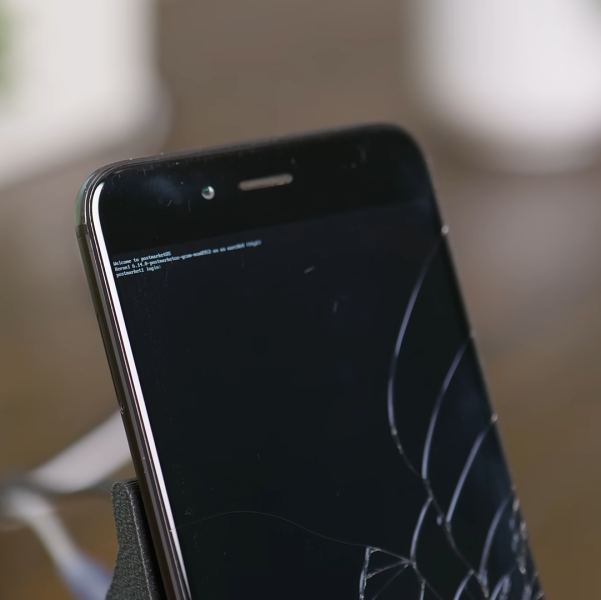

Some people like their homelabs to be as big and fancy as possible, with racks of new or surplus server hardware sucking down power. [Hardware Haven] evidently has the opposite idea, given he just made a video about making the cheapest, smallest server possible: an Android phone.
Sure, it’s not going to be streaming terabytes of data at multiple gigabytes per second, but that’s not everyone’s use case. Don’t forget, flagship phones had multiple cores and gigabytes of RAM a decade ago, so even an old and busted smartphone has more than enough power for something like Home Assistant, which is what gets installed in this video.
After considering loading termux and rooting his device for Docker-on-Android, he opted for postmarketOS, the premiere Linux for old smartphones. That’s not because the Linux environment you get with termux wouldn’t work; it’s just that he wanted something native. To that end, he bought a somewhat worse-for-wear Xiaomi Mi A1 from eBay to get hardware Alpine-based postmarket could use.
Software wise, it was just a matter of following instructions and reading manuals — Linux is Linux, after all. The firewall proved to be his main challenge, though trying to branch out from Home Assistant to run Minecraft Server did run into Java issues [Hardware Haven] had no interest in troubleshooting. Hardware wise, though, well — do you want to leave a phone plugged in permanently? Smokey the Bear suggests you not, especially if you live near a forest. Besides, you probably don’t want your server on WiFi, and at least this smartphone wouldn’t charge when using a networking dongle.
That meant phone surgery: the battery came out, and 5 V from an old USB charger was piped into the battery charge controller via a diode. The diode was used for its voltage drop, to bring the 5 V supply down to a believable battery voltage — a buck converter might have been better, but you use what you have, and the diode drop doesn’t dissipate much power. Power dissipation is still one watt at idle, six during a stress test.

Note that the diode forward voltage depends on the current you draw through it. The normal assumption of 0.7 Volts holds for large currents, while for small currents in the microamps or milliamp range for large diodes, the forward voltage drop might be halved.
In other words, if you take a 5 Volt supply and pretend to be a lithium battery by a diode, it may work until you turn the device off, at which point the charge controller sees a much higher voltage and may not turn back on because it thinks the “battery” is overcharged and possibly damaged. It may also damage the charge controller and/or any component down the line.
Solution: use two diodes in series. The simulated battery will look emptier but you’ll be squarely within the normal battery voltage range.
The bigger issue with the setup is the power dissipation. If your maximum power draw at 100% load is 6 Watts at 5 Volts, then 1.2 Amps must be going into the device, which means the diode will see just under a Watt of heating, which may still bring Smokey the Bear around for a visit. What’s more likely, you’ll hear a pop and smell something acrid, and the phone suddenly stops working.
Solution: pick a larger diode rated for more amperage and leave it outside of the phone where it can cool itself.
Or, just use an Lm317 or similar adjustable regulator.
Some LDO would do – LM317 has too much drop.
Also, same problem with the heat dissipation. A Watt is a lot unless you have a heatsink.
