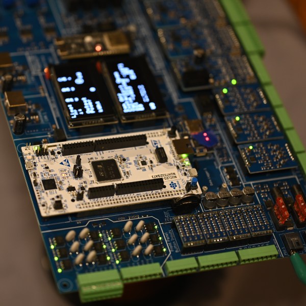

The site controller board
Over on brushless.zone, we’ve come across an interesting write-up that details the construction of a dam control system. This is actually the second part, in the first, we learn that some friends purchased an old dysfunctional 80 kW dam with the intention of restoring it. One friend was in charge of the business paperwork, one friend the mechanical side of things, and the other was responsible for the electronics — you can probably guess which ones we’re interested in.
The site controller is built around a Nucleo-H753 featuring the STM32H753ZI microcontroller, which was selected due to it being the largest single-core version of the dev board available. This site controller board features a dozen output light switches, sixteen front-panel button inputs, dual 24 V PSU inputs, multiple non-isolated analog inputs, atmospheric pressure and temperature sensors, multiple analog multiplexers, a pair of SSD1309 OLED screens, and an ESP32 for internet connectivity. There’s also fiber optic TX and RX for talking to the valve controller, a trio of isolated hall-effect current sensors for measuring the generator phase current, through current transformers, four contactor outputs (a contactor is a high-current relay), a line voltage ADC, and the cherry on top — an electronic buzzer.
The valve controller has: 48 V input from either the PSU or battery, motor phase output, motor field drive output, 8 kV rated isolation relay, limit switch input, the other side of the optical fiber TX and RX for talking to the site controller board, and connectors for various purposes.

  3. I do not like the monolithic PCB. One major *uckup and you are left with a plethora of bodge components or PCB patches and a jungle of wires because of no time/$$ to re-spin the board. Also any major upgrade would not be easy or even feasible. And the H753 is bugged af and using it in any mission-critical scenario without an moderately sophisticated micro-based watchdog is what we call here a call to devil for help.
    Nevertheless, good luck with such a endeavor!
    1. I’m glad you said this.
      While this is a cool project, the mission success criticality of this project should’ve necessitated a PLC. The AutomationDirect Click Plus line would’ve been a great budget choice, or if you were feeling fancy a Beckhoff CX system. Hell, probably could’ve gotten away with a Raspberry Pi running Codesys and a couple of etherCAT modules would’ve probably also done the trick.
