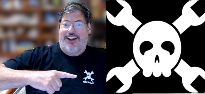

Adding a Watermark
FFmpeg’s filter graph system is quite flexible. A watermark is just another video source composited over the main image. Suppose you have a PNG file named wrencher.png with transparency. This command overlays it in the lower-right corner:
ffmpeg -f v4l2 -i /dev/video0 -i wrencher.png -filter_complex "overlay=W-w-20:H-h-20,format=yuv420p" -f v4l2 /dev/video10
Or, you could be more explicit:
ffmpeg -f v4l2 -video_size 1024x720 -framerate 15 -i /dev/video0 -i wrencher.png -filter_complex "overlay=x=main_w-overlay_w-20:y=main_h-overlay_h-20,format=yuv420p" -f v4l2 /dev/video10
Now the logo appears 20 pixels from the bottom-right edge. However, note that if your software “mirrors” your image for local display, the watermark will go to the other side in your view. That makes sense.
If your video fails, or it looks like color garbage or a green screen, you may have to pick a different video conversion other than yuv420p.
Perhaps a bit large for a watermark, but you get the idea.

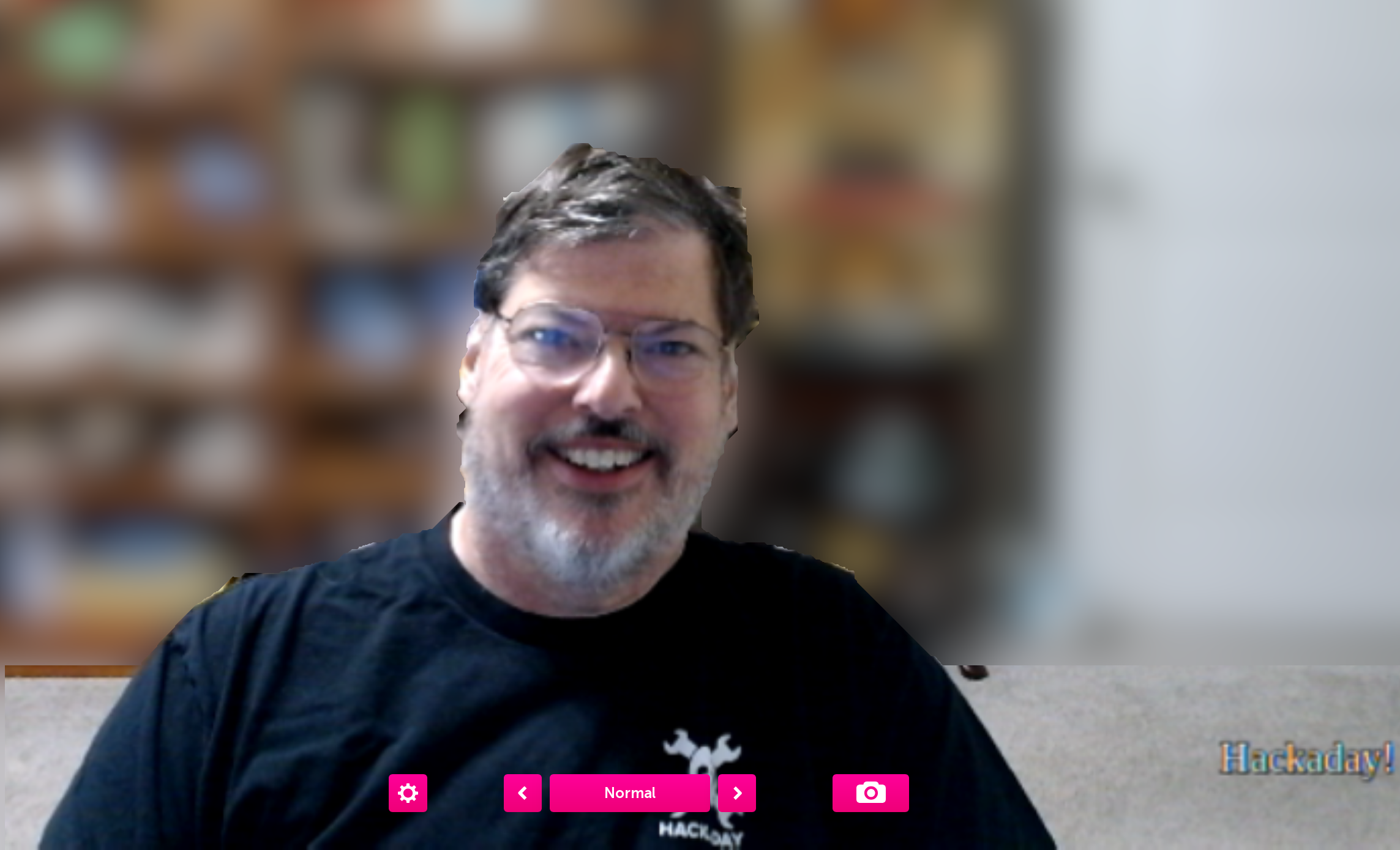

Suppose you want to add text:
gst-launch-1.0 v4l2src device=/dev/video0 ! videoconvert ! textoverlay text="Hackaday!" valignment=bottom halignment=right ! v4l2sink device=/dev/video10
