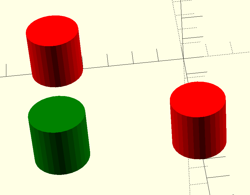

What I really wanted to do is create one OpenSCAD file that shows the colors I am using on the screen. Then, when I’m ready to generate STL files, I should be able to just pick one color for each color I am using.
Luckily, OpenSCAD lets you easily define modifiers using children(). You can define a module and then refer to things that are put after the module. That lets you write things that act like translate or scale that modify the things that come after them. Or, come to think of it, the built-in color command.
Simple Example
Before we look at color output, let’s just play with the children function. Consider this code:
module redpart() {
color("red") children();
redpart() cube([5,5,5]);
That makes a red cube. Of course, you could remind me that you could just replace redpart() with color("red") and you’d be right. But there’s more to it.
Let’s add a variable that we set to 1 if we don’t want color output:
mono=0;
module redpart() {
if (mono==0) color("red") children();
else children();
Now We’re Getting Somewhere
So what we need is a way to mark different parts of the OpenSCAD model as belonging to a specific filament spool. An array of color names would work. Then you can select all colors or just a specific one to show in the output.
colors=[ "black", "white", "blue","green"]; // Set to -1 for everything current_color=-1;
All we need now is a way to mark which spool goes with what part. I put this in colorstl.scad so I could include it in other files:
module colorpart(clr) {
color(colors[clr])
if (clr==current_color || current_color==-1) {
children();
else {
So you can say something like:
colorpart(2) mounting_plate();
This will not only set the mounting_plate to the right color on your screen. It will also ensure that the mounting_plate will only appear in exports for color 2 (or, if you export with all colors).
