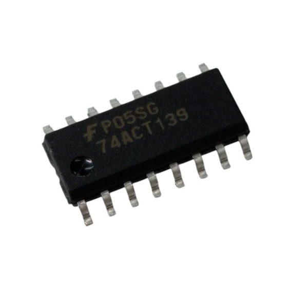

When we think of a motor controller it’s usual to imagine power electronics, and a consequent dent in the wallet when it’s time to order the parts. But that doesn’t always have to be the case, as it turns out that there are many ways to control a motor. [Bram] did it with a surprising part, a 74ACT139 dual 4-line demultiplexer.
A motor controller is little more than a set of switches between the supply rails and the motor terminals, and thus how it performs depends on a few factors such as how fast it can be switched, how much current it can pass, and how susceptible it is to any back EMF or other electrical junk produced by the motor.
In this particular application the motor was a tiny component in a BEAM robot, so the unexpected TTL motor controller could handle it. The original hack was done a few decades ago and it appears to have become a popular hack in the BEAM community.

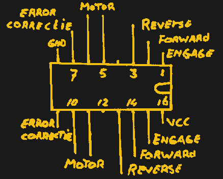

    1. Why does this specific drawing style trigger medical issues? Feel free to enlighten us so that we can prevent your specific medical discomforts in the future.
      1. It’s because neither the pin numbers nor their orientation have any meaning. 74xx139 has an enable input, two “address” inputs and 4 “selector” outputs, and none of that information is given in the “schematic”. It’s completely usesless to understand how the circuit works.
        And a similar (text based) graph is on the hackaday.io project page. It’s not helpful.
        Also for Hackaday: A tag of “motor conteoller” is not very useful. Please fix that.
        1. And that’s putting the hack in the hack.
          Why this hack exist isn’t explained; it’s driving four outputs from three inputs, which accomplishes what?
        2. It’s a drawing of a piece of plastic-encased leaded silicon. It was perfectly clear to me fwiw. Which is to say, i looked at the cover image and felt like the article was 99% redundant after that. “my motor draws single digit mA so i got away with this.” :)
