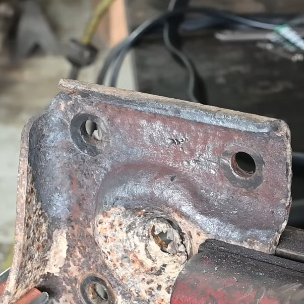

Plasma cutters work by forcing compressed air through a small nozzle, and ionizing it with a high voltage. This process converts the gas into a very maneuverable stream of electrically-conductive, high-temperature plasma which can do useful work, like cutting through metal. The particular unit demonstrated also has a rust removal function. By operating at a much lower level, the same plasma stream can be used to give an effect not unlike sandblasting.

Meh – I didn’t know you could use a plasma cutter to remove rust, so that’s both useful information and potentially going to inspire someone to hack up something that can do it DIY.
