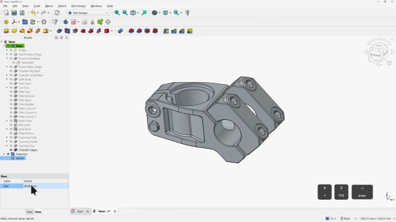

    1. My criticism of the video is:
      1) They didn’t explain why the sketch was drawn with a hole around the origin. Usually you want your reference point to be some physical corner instead of an abstract point hanging in the air, because you’re going to be using that point to check your tolerances and align your material in whatever machine you’re using. You also don’t want to stack your dimensions, you want to refer them to the same point to make the machinist’s life and your own easier, so in that regards this video does not represent best practices in all cases.
      2) The tutorial has you split the model into multiple floating pieces. While FreeCAD allows this, this is generally a no-no for modeling in feature editing style (Part Designer) because it’s one way to cause topological reference problems and dependency loops that can break your model entirely.
      A Part Design Body with multiple disconnected pieces is a hack that is just technically possible because they left the option in. You can build a model like this, but beware that using these methods can cause you headaches. At least remember, never try to join the separate pieces back together again.
      The correct way to do it is to model each separate piece on their own and then combine them in assembly. In most other CAD packages you wouldn’t need a separate workbench for adding things like fasteners either, because that too would be handled in the assembly context. Unfortunately FreeCAD does not support assembly very well.
