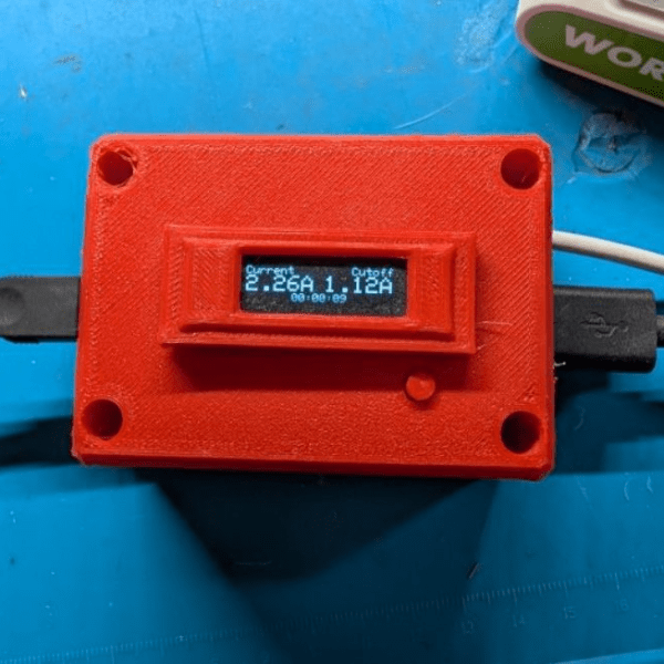

By sampling charge current and disconnecting when it drops to 50 percent of peak, charging is reliably stopped when the target device is 80 to 90 percent charged, regardless of cell count or capacity.
ChargeCap sits between a USB charger and target device, disconnecting when it detects that recharging is 80 to 90 percent complete. This is particularly useful for maximizing the cell life of devices that see only intermittent use.
The way ChargeCap does this is clever, and relies on the fact that all lithium-ion charging curves look the same regardless of cell capacity or cell count. Charge current remains at pretty much the same level for most of the charging process, but tapers off quickly (and in a linear fashion) as cells approach their maximum capacity. That’s because charging a battery is a lot like blowing up a balloon: the first breaths are easy, but once the balloon fills out, every breath needs to push harder than the last.
ChargeCap works by sampling the peak charge current at the beginning of the charge cycle, then detecting when it drops below 50 percent of peak, at which point charging is stopped. The result is a device that reliably charges to 80 to 90 percent of capacity, and no more. ChargeCap uses an ESP32-C3 and a small OLED display that, as a nice touch, inverts colors to signal charge completion. Design files and code are at the GitHub repository.

      The only problem I see is that the logic to stop charging seems to rely on the device having SOME drain for it to detect current draw changes.
      This wouldn’t work with a flashlight that you want to keep plugged in, use it outside for 2 minutes, then put it back on the charger. Or other devices you only use in short bursts that live mostly in storage.

  4. For anything involving a single battery cell (“3.7v”, “4.2v”, etc) this is a brilliantly simple solution. For something with multiple cells, like the 7.2v workpro glue gun(?) in the photo, it’s still probably good, but the benefit is a little less clear-cut.
    To maximize the lifespan of multi-cell lithium batteries, proper cell balancing is also important, and devices that use “top balancing” are pretty common. It’s a simple, cost-effective method that uses resistors to bleed off charge to some cells and allow the undercharged ones to catch up. Unfortunately, that means it doesn’t usually kick in until the battery is closer to fully charged than this device will allow.
    So, that means you should probably still charge such devices to 100% every once in a while to maximize their lifespan, but unless you have some way to measure the voltage of each cell separately, there’s no good way to know when “once in a while” actually is.
    (and if you have a way to measure cell voltage independently, you also probably have a way to implement your own balancing solution that solves this problem)
    1. When they get severely imbalanced, you would notice lower battery life. But not because the cells are harmed. So you’d get all that battery life back if you charged fully (and kept it full so they can balance) at that point.
      Personally I think potential cell imbalance is overblown in most devices – especially small battery, low charge current type of devices this is aimed at. Maybe in a year or two I’ll check my glue gun and see if the two cells are out of whack.
