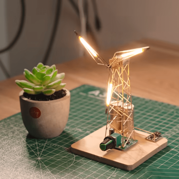

Typically, lamps provide a stationary source of light to illuminate a given area and help us see what we’re doing. However, they can also be a little more artistic and eye-catching, like this windmill lamp from [Huy Vector].
It’s somewhat of a charming desk toy, constructed out of copper wire soldered into the form of a traditional windmill. At its base, lives a simple motor speed controller, while up top, a brushed DC gearmotor is responsible for turning the blades. As you might imagine, it’s a little tricky to get power to flow to the LED filaments installed on those blades while they happen to be rotating. That’s where the build gets tricky, using the output shaft of the motor’s gear drive and a custom slip ring to pass power to the LEDs. That power comes courtesy of a pair of 16340 lithium-ion cells, which can be juiced up with the aid of a USB-C charger board.

It’s kinda brave to build an uninsulated circuit sculpture with non-protected li-ion cells.
Otherwise looks very nice!
You could put some lacquer on the feed lines, the charging module has protection so it’s only the lines from the batteries to the module that are a theoretical risk if something metal falls on it.
Or maybe put the charging module right next to the batteries, in a nice way, and maybe an extra current limiter for extra safety if so inclined, then do all the brass and copper to the rest of the design.

I’m not worried about something falling on the model, i’m worried about something falling off the model, given that it’s got moving parts :)
What about direct soldering to battery contacts?
What about hot gluing a linear charger pcb that gets hotter than the melting temperature of hot glue?

Any ideas for a slow, smooth and low power consumption motor to use here?
Follow the first link in the article, it has a link to aliexpress.
The one they used seems a little too noisy, and probably a little power hungry for the task. I wonder if better options exist.
The generic “N20” motors seem to be a little quieter. They’ll all be a bit noisy, as they’re a high speed motor geared down to get torque.
A small stepper motor might be a better choice.
This is a fine craft-style video, but for more soothing windmill projects look into SimpleFOC project. With an esp32 or rp2040 plus minimal MOSFET driver boards you can make a brushless motor spin as slow as you want, consuming as little as you dictate.
What about cannibalizing a quartz analog clock module? Low but enough torque, quiet, outstandingly low power consumption. With some 3D print tinkering, you could even procure a more compact gearbox.
The other possible option would be an ultrasonic motor. Or a vibra motor from a cellphone – they’re dirt cheap.
