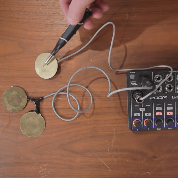

The key to the contact mic is the piezo disc. It’s an element that leverages the piezoelectric effect, converting physical vibration directly into an electrical signal. You can get them in various sizes; smaller ones fit into tight spaces, while larger ones perform better across a wider frequency range.
[The Sound of Machines] explains how to take these simple piezo discs and solder them up with connectors and shielded wire to make them into practical microphones you can use in the field. The video goes down to the bare basics, so even if you’re totally new to electronics, you should be able to follow along. It also covers how to switch up the design to use two piezo discs to deliver a balanced signal over an XLR connector, which can significantly reduce noise.
There’s even a quick exploration of creative techniques, such as building contact mics with things like bendable arms or suction cups to make them easier to mount wherever you need them. A follow-up explores the benefits of active amplification. The demos in the video are great, too. We hear the sound of contact mics immersed in boiling water, pressed up against cracking spaghetti, and even dunked in a pool. It’s all top stuff.

  2. The video is bad on many levels. For starters the metal disc isn’t copper but brass, then it skips mentioning impedance which is extremely important as those are piezoelectric transducers and most amplifiers and their inputs are designed for mic/line level signals with quite low impedance, then it uses a completely unnecessary dual mic arrangement when it could simply use one transducer wired between the two hot wires of the balanced cable, then properly connect the ground braid, that is, not connecting it at all on the transducer but leaving it connected on the plug, so it would short any noise to the amp/mixer ground. Then it fails to mention that for a contact mic to properly work, it needs a counterpoise to build some inertial mass that counters the vibrations transmitted on the other side of the piezoelectric material. Just glue a small weight on the side that isn’t in contact with the object; that would increase the output by a big margin.
