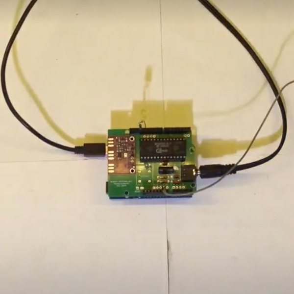

The chip in question is an SP0256A-AL2, which you may remember from various speech projects for 8-bit computers back in the day. It can talk, after a fashion, by reproducing 56 “allophones” — the sounds that make up English speech — from ROM. Singing, though? We cannot recall much of that back in the day, but then, a talking computer was impressive enough.
As it turns out this is building on an earlier hack [Kevin] did in which he used an Arduino to make the venerable speech chip MIDI controllable. In that project’s write-up it is revealed that a Si5351 programmable clock module is used to give a variable pitch signal to the speech synthesizer. In this way he’s able to get about an octave an a half, which is good enough when the carol in question only spans one octave.
Of course the pitch signal needs to be varied by something and for that the venerable Arduino once again takes the place of an 8-bit computer. In this case it’s pre-programmed, but can also be set up for MIDI control.Of course nothing says you can’t use true retro hardware or a more-capable RP2040 instead of the Amtel chip.

  1. Could this have been done in the 1980s (i.e., without the Arduino)? This seems to indicate it could have, “Of course the pitch signal needs to be varied by something and for that the venerable Arduino once again takes the place of an 8-bit computer. “
    1. The key trick here is being able to vary the frequency of the oscillator driving the speech chip. It usually requires ~4MHz, but by varying it in a semi-controlled way, almost an octave and a half is possible. If that can be controlled and synchronised with the allophones, then yes, in principle an 80s microcontroller could also do it.
