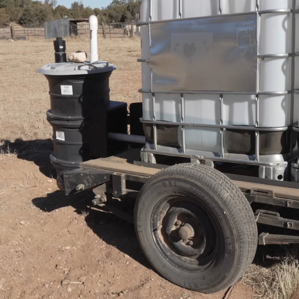

Living without standard utility hookups like electricity, Internet, water, and sewer comes with a whole host of challenges, all of which are most commonly solved by spending lots of money. For electricity, a solar array or a generator is fairly common. The Internet can similarly be accessed via a satellite link if wires aren’t available. For water, most people will drill a well, but that gets similarly expensive. [Cranktown City] recently bought an off-grid home and needed a way to get water to it on a budget, so he built this water trailer instead.
The trailer started off as a standard single-axle utility trailer. The weight rating was probably around 3,500 pounds or 1588 kg. A few support structures were welded in. The supports serve double duty as a frame for two IBC totes, which can hold about 550 gallons or 2082 liters of water. The trailer also got upgraded wiring, including some extra wires to support a backup camera. The two totes were then plumbed together with a ball valve for an outlet. That valve was mated to a motor that can be remotely activated from within a truck to dump the water out into a cistern.
On the cistern side, [Cranktown City] welded up a door with a linear actuator and a remote control. When he’s ready to dump the water into the cistern, he can easily back up the trailer using the backup camera, open the door to the cistern remotely, and then activate the ball valve on the trailer to start filling the reservoir. It’s a clever solution to bringing water to his off-grid property at a fraction of the cost of a drilled well. We’ve seen some other unique ways to live off-grid as well,  like this hydroelectric generator, which might offset the cost of an expensive solar array.

        1. Honestly, if we are going by the high level engineering view here. 2082 liters of water weighs 2082kg, and that trailer (when new and not rusty) has a stated weight capacity of 1500kg. Which is a safety factor of 0.72. Godspeed dear maker…

  3. Since we dont know the true rating for the trailer I’m unsure but if it carries 550 gallon that’s over 4500 lbs then the trailer seems to be way over its weight rating. The ratings for the axle should be on a specs tag. I just hope this isnt on public roads that far overweight especially given waters propensity to move around. This could be very dangerous. That’s my two cents. I’m just an RV tech. What do i know.

  6. Since that looks like a 5-bolt pattern, I would say 1588 kg of Gross Vehicle Weight Rating is a good guess.
    But when you subtract tare, the total weight of all the equipment (even the axle itself) estimating 400 kilos for the trailer, maybe 50 each for the totes, and let’s go 150 for all the plumbing, support structure, and pump and you are left with a net of 938 kg. That doesn’t even fill one tote.
    And this is assuming legal GVWR for his jurisdiction is actually 1588, and it’s not just the factory rating for the axle.
    My tank truck axles (tri-drive and fat steers) can haul around 84500 kg, but the law in Alberta only allows me to haul 31300. And that’s before I subtract the 15600 tare.
