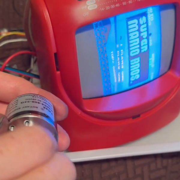

If you’ve got a decent CRT monitor, you can usually adjust the settings to make sure the image scans nicely across the whole display. But what if you could rotate the whole image itself? [Jeri Ellsworth] has shown us how to achieve this with an amusing mechanical hack.
The trick behind this is simple. On a standard CRT, the deflection yoke uses magnetic coils to steer the electron beam in the X and Y axes, spraying electrons at the phosphors as needed. To rotate the display as a whole, you could do some complicated maths and change how you drive the coils and steer the electron beams… or you could just rotate the entire yoke instead. [Jeri] achieves this by putting the whole deflection yoke on a custom slip ring assembly. This allows it to receive power and signal as it rotates around the neck of the tube, driven by a stepper motor.
Amusingly, [Jeri] even found a super nifty way to drive the stepper. There are no microcontrollers or fancy driver logic here—instead, the quadrature output from a rotary encoder outputs a perfectly legible pulse train which can drive the stepper as needed. [Jeri] notes this provides a nicely instantaneous response. There’s still work to be done, too. The project is due to get a 3D-printed housing, a homing system, and some improvements to the DIY slip ring setup.

        1. The two coils are not identical. They have different amount of windings and inductance. Using the vertical coil to do the horizontal scanning isn’t going to work. Too high inductance (too slow).
      2. 2d rotation matrices are literally covered in high-school pre-calculus maybe even Algebra 2. Are you absolutely sure you can’t just use one of those?
    2. cool you just repeated sentence 6 of this article, which says:
      “To rotate the display as a whole, you could do some complicated maths and change how you drive the coils and steer the electron beams… or you could just rotate the entire yoke instead.”
      The whole idea behind this project is to keeping it simple by doing it WITH moving parts. Although simple is a relative term biased by what you are familiar with.
    3. You are designing a vector monitor. Since you can’t rely on the horizontal coil being scanned fast enough to generate the high voltage flyback pulses, instead of using a flyback transformer, you’ll have to get the high voltage for the CRT anode elsewhere (like in vector monitors – they do have flybacks, but these are disconnected from the yoke).
    4. Rotating the image with no moving parts is easy with an electrostatic-deflection CRT, like from an oscilloscope.
      Even the math is trivial.
      Doing it with a magnetic yoke is a bit more difficult. As SDS points out, you’ll need to ensure you have a HV supply, often (not always!) provided by the horizontal scan circuit. But you’ll also need to provide drive circuitry for the yoke coils that don’t rely on driving a resonant circuit — the horizontal and vertical frequencies differ by a factor of 525.
      But I’d really like to hear what Jeri is planning with this — it looks like something fun.
    5. For what it’s worth, there were WW2 radar displays using magnetic-deflection CRTs, which featured rotating yokes.
      Not sure what the end-game is for this project, but spinning a yoke to rotate a screen image on a CRT is actually well-travelled ground.
      1. I believe this is how all early ANALOG radars worked. Your scan line went from center of CRT to edge, then rotate the yoke in sync with the radar dish. The scan line would start from the center at the time the radar pulse was generated, the radar echo showed up as a blip on the scan line depending on how long it took to return.

  5. The display of a Raytheon marine radar of the 1950’s and 60’s has this. It is basically their late WWII unit for the the civilian market. It was standard for RADAR displays of all sorts. You can hear the motor while using one. Also the comforting high RPM spin-up of the Dynamotors that provide the higher voltages for the tube based electronics. Derived from the 12/24/48 volt environment of boat or aircraft.
    1. I was going to make the same comment, were synchro motors were used to move the CRT coil to match the direction of the radar antenna.
      1. I forgot about that! I had some synchro’s back then connected by 3 wires that would run on 110V AC. They are so cool. Turn either one and the other follows. Spin either one with no load and they “run-away”. They are such a simple way to match an angular position remotely. On a warship’s bridge you could take a sighting on something (or a periscope, etc) and something would move on a plotting table, or be an input to a mechanical analog computer that produces course and speed of a target or a firing solution, etc. I’m surprised we don’t see them being used today.
