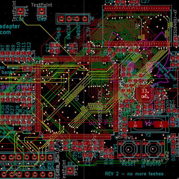

  4. CRT that runs at an unusual 336 by 262 pixel resolution
    CRTs dont have pixels or exact horizontal resolutions :) Its ordinary 15.7kHz CRT, 240 visible lines. Previously they ran it with Gert vga666 set to 240 visible + porches = 262 https://www.frankchiarulli.com/blog/building-the-rcade/
    Article:
    length-matched traces between the STM32 and the HyperRAM. Length-matching ensures that all the signals arrive at the same time; if some arrive too early or late it can cause issues
    later on Author states
    I basically redesigned the entire board from scratch. … but I needed completely new RAM (the new chip has no HyperBus)
    but he doesnt use hyperbus
    there is SDRAM on board, but memory.x says its not used at all
    this micro has 1MB of SRAM so no external ram would be needed anyway at those small framebuffer sizes
    Looking at PCB:
    huge cuts in ground plane right across Ram address/data bus, good thing he doesnt use this ram at all :)
    whole PCB ground plane is cut in half by ram and VGA routed in the ground layer :o
    0.3 hole 0.4 diameter VIAs have extremely small annular ring, afaik very bad idea leading to manufacturing/reliability problems. I am guessing author tried to make small clearance VIAs but instead broke them while leaving huge (0.5mm) clearances overridden by GND/Power plane settings. Those settings arent entirely obvious and one might give up trying to find what is locking clearances.
    usb impedance mismatch, but meh its short
    usb differential impedance mismach is bad with one DM crossing thru two vias, length mismatch by ~120mils
    bypass cap right along USB High speed track also not good
    all usb ULPI signals going over huge ground hole no bueno
    This is probably the part where I’m supposed to say that like, crosstalk is bad and stuff, but we’re just gonna ignore that. I had like no space; leave me alone!
    Length matching (up to 10mm margin) will be less important on 60MHz ULPI than crosstalk between 4mil tracks routed with just 4mil clearance without solid ground underneath.
    Im loving the can do plowing thru obstacles attitude. Author got there in the end and made working solution to his initial problem.
