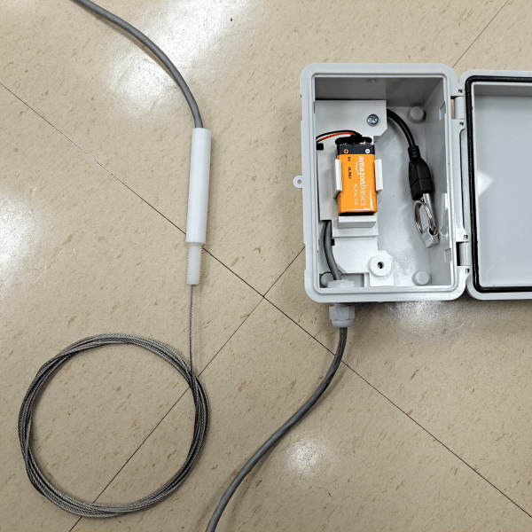

Water wells are simple things, but that doesn’t mean they are maintenance-free. It can be important to monitor water levels in a well, and that gets complicated when the well is remote. Commercial solutions exist, of course, but tend to be expensive and even impractical in some cases. That’s where [Hans Gaensbauer]’s low-cost, buoyancy-based well monitor comes in. An Engineers Without Border project, it not only cleverly measures water level in a simple way — logging to a text file on a USB stick in the process — but it’s so low-power that a single battery can run it for years.
The steel cable (bottom left) is attached to a submerged length of pipe, and inside the cylinder is a custom load cell. The lower the water level, the higher the apparent weight of the submerged pipe.
The monitor [Hans] designed works in the following way: suspend a length of pipe inside the well, and attach that pipe to a load cell. The apparent weight of the pipe will be directly proportional to how much of the pipe is above water. The fuller the well, the less the pipe will seem to weigh. It’s very clever, requires nothing to be in the well that isn’t already water-safe, and was designed so that the electronics sit outside in a weatherproof enclosure. Cost comes out to about $25 each, which compares pretty favorably to the $1000+ range of industrial sensors.
The concept is clever, but it took more that that to create a workable solution. For one thing, space was an issue. The entire well cap was only six inches in diameter, most of which was already occupied. [Hans] figured he had only about an inch to work with, but he made it work by designing a custom load cell out of a piece of aluminum with four strain gauges bonded to it. The resulting sensor is narrow, and sits within a nylon and PTFE tube that mounts vertically to the top of the well cap. Out from the bottom comes a steel cable that attaches to the submerged tube, and out the top comes a cable that brings the signals to the rest of the electronics in a separate enclosure. More details on the well monitor are in the project’s GitHub repository.
All one has to do after it’s installed is swap out the USB stick to retrieve readings, and every once in a long while change the battery. It sure beats taking manual sensor readings constantly, like meteorologists did back in WWII.

  3. I’ve been trying to figure out a good way of doing exactly this for a long time. This is a pretty good idea. My only concern is that if the tube doesn’t hang quite straight then friction between it, the walls of the tube and the other things running the length of the well will dominate over the buoyancy of the pipe.
    1. The tube never moves, you’re only measuring it’s apparent weight. Because of this you won’t see friction (a force that acts on objects moving against each other) enter the situation. Only if the bounancy force becomes so extreme as to bend the tube’s supports does this become an issue, and then you’ve got other problems.
      1. Of course the tube moves: It’s suspended from a load cell. That’s how a load cell works: it measures the deformation in its strain gauge to determine the force applied to it.
        Heck, it’s right in the name: strain is by definition movement.

  5. I made something like that years ago ,it works, but not for years , first of all :loadcells need calibration rather often because they drift , second: a weight submersed in water will attract dirt and thereby buoyancy will change over time and third: as TOm says, the least friction will spoil the reading ,but if you overcome this, its smart because, if the partly submersed rod at a given height has a geometri with a known relation to the well at same height you can from the displaced weight , calculate the weight(amount) of the liquid in the well(container) and it would even work with pressurized gases .
    1. I doubt the drift will be large enough to matter. A coarse reading that’s 20% off is probably good enough. Friction doesn’t enter the situation in an essentially fully static system that measures buoyant force, see my above comment.
      1. the friction WILL make a problem. imagine the extreme: the steel cable stuck or anchored in the middle. the change of buoyancy force transferred by the cable will be stopped at this point.
      2. I doubt the drift will be large enough to matter. A coarse reading that’s 20% off is probably good enough.
        If the weight is steel, then full scale is 87% ie 13% change. Unless your weights are matched to the load cell full scale range, then it is less. e.g. if the weight is 10% of load cell full scale, then the maximum change will only be 1.3% of load cell full scale.
        Now if you said that the objective was 5% accuracy of water depth, then we are down to 0.07% of load cell.
        Long term drift and temperature coefficients are likely to matter.
