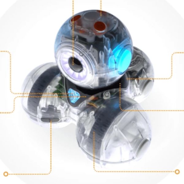

A marketing image of a Dash educational robot is shown. It is made of a triangle pyramid of four plastic spheres. Two of the base spheres house wheels, and the top sphere houses a speaker, lights, and sensors.
One of the joys of browsing secondhand shops is the possibility of finding old, perhaps restorable or hackable, electronics at low prices. Admittedly, they usually seem to be old flat-screen TVs, cheap speakers, and Blu-ray players, but sometimes you find something like the Dash, an educational toy robot. When [Jonathan] came across one of these, he decided to use it as a turtle robot. However, he found the available Python libraries insufficient, and improving on them required some reverse-engineering.
While [Jonathan] was rather impressed with the robot as it was – it had a good set of features, and thought had clearly been put into the design – he wanted a more open way to control it. There was already a quite useful, official Python program to control the robot over a BLE connection, but it only worked with Python 2 on OS X ([Jonathan] theorizes that it might have been written as a development tool, open-sourced, and not diligently supported afterwards). There were also a few third-party libraries ported to Python 3, but they all seemed to be missing some important features.
