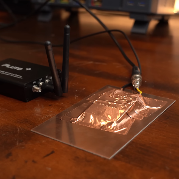

[GreatScott] has recently been tinkering in the world of radio frequency emissions, going so far as to put their own designs in a proper test chamber to determine whether they meet contemporary standards for noise output. This led them to explore the concept of shielding, and how a bit of well-placed metal can make all the difference in this regard.
The video focuses on three common types of shielding—absorber sheets, shielding tapes, and shielding cabinets. A wide variety of electronic devices use one or more of these types of shielding. [GreatScott] shows off their basic effectiveness by putting various types of shielding in between a noise source and a near-field probe hooked up to a receiver. Just placing a bit of conductive material in between the two can cut down on noise significantly. Then, a software defined radio (SDR) was busted out for some more serious analysis. [GreatScott] shows how Faraday cages (or simple shielding cabinets] can be used to crush down spurious RF outputs to almost nothing, and how his noisy buck-boost designs can be quieted down with the use of the right absorber sheets that deal well with the problematic frequencies in question. The ultimate upshot of the tests is that higher frequencies respond best to conductive shielding that is well enclosed, while lower frequency noise benefits from more absorptive shielding materials with the right permeability for the job.

      anyway here’s something I’ve been doing that seems to work pretty well and I tried to get my company interested in pursuing it officially but they were all naah, so: take your pcb design, export it as a step, import that into your cad program of choice and make it a boolean cut out of a block of material, then when you’ve got the inverse shape, print that in conductive filament and plate it with copper, and you have a cheap conformal shield. It works pretty well just with the conductive filament. Make sure it’s grounded. I use PTH around the mounting screws for the shield.
      Give yourself wiggle space around your inductors, though. There’s a surprising amount of variation in them, particularly if someone’s hand-soldering. And don’t forget electrical clearance rules.
