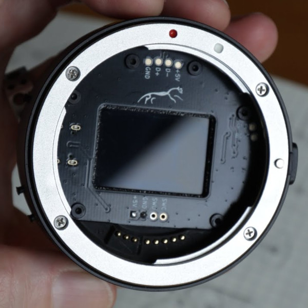

For a long while, digital single-lens reflex (DSLR) cameras were the king of the castle for professional and amateur photography. They brought large sensors, interchangeable lenses, and professional-level viewfinders to the digital world at approachable prices, and then cemented their lead when they started being used to create video as well. They’re experiencing a bit of a decline now, though, as mirrorless cameras start to dominate, and with that comes some unique opportunities. To attach a lens meant for a DSLR to a mirrorless camera, an adapter housing must be used, and [Ancient] found a way to squeeze a computer and a programmable aperture into this tiny space.
The programmable aperture is based on an LCD screen from an old cell phone. LCD screens are generally transparent until their pixels are switched, and in most uses as displays a backer is put in place so someone can make out what is on the screen. [Ancient] is removing this backer, though, allowing the LCD to be completely transparent when switched off. The screen is placed inside this lens adapter housing in the middle of a PCB where a small computer is also placed. The computer controls the LCD via a set of buttons on the outside of the housing, allowing the photographer to use this screen as a programmable aperture.
The LCD-as-aperture has a number of interesting uses that would be impossible with a standard iris aperture. Not only can it function as a standard iris aperture, but it can do things like cycle through different areas of the image in sequence, open up arbitrary parts or close off others, and a number of other unique options. It’s worth checking out the video below, as [Ancient] demonstrates many of these effects towards the end. We’ve seen some of these effects before, although those were in lenses that were mechanically controlled instead.

  2. The execution on this is excellent. It’s an older idea, at least in some scientific circles. One of the issues with these if I recall is the dark regions don’t block enough light for a lot applications. For photos at normal conditions it’s probably great.
    Adafruit sells little lcd light shutters, but I do wish there was a nonhacked version of screens like this. Yes I said nonhacked sorry. I hate dealing with LCDs and removing backlighting.
    Super cool project though
    1. While true light valve operation won’t be possible with this screen, it’s not out of the question, and depending on the lighting conditions may be unnecessary. Still, putting an exotic piece of optical kit within reach for even hobby use like this is pretty incredible. The old systems this approximates weren’t exactly able to be used as field cameras either, so there are true advancements even in this implementation.
      1. Looks like this may be susceptible to infrared leakage unless they took specific steps to deal with it, UV should be blocked though.
        1. That poor-man’s light valve will, but the modern-ish sensor will itself have a pretty good IR-cut filter on it. There might be a thin slice around 750 nm that’s an issue.
  3. I think the further an aperture is from the nodal point of the lens the more likely it is to cause vignetting and this is as far as they get. So I think this would be limited to creative vignettes/masking and a built-in neutral-density filter.
  4. I looked it up shape is because of predators, grazing in large open spaces is extremely dangerous. So the shape and eyeball and orientation can give them between 270 to 320 degrees of view. They can almost see what is behind them. And a flock or heard grazing never align to avoid having dangerous blind spots.
  5. Amazing work, a very professional level of competence on display there too! Perhaps not how it is now, but a future version could also perform contrast masking where one can achieve a HDR like effect by giving some areas of the image more or less exposure than others. Normally this mask would be closer to the imaging plane but with some math an aperture type contrast masking effect may be possible, after all it is just about constructing the desired light field on the sensor. You would be essentially treating the aperture as a Coded Aperture, this would essentially create a spatial light modulator (SLM) system.

    1. All LCDs use two polarizers — that’s a fundamental part of how they work. So expected. My concern would be that they’d linear polarizers, and many modern cameras need circular polarizers for their metering and autofocus to work correctly.
  11. Impressive implementation and good demonstration of the effects.
    But an LCD will drop at least 50% of the light when “clear” and mess with polarization. The blockage when switched to dark is also not perfect. I would expect an out of focus highlight from the scene to blur unexpectedly.
    Still – nice tool If you know what you are doing, but unlikely to be found in commercial cameras anytime soon.
  12. Very similar to the paper Lensless Imaging with a Controllable Aperture by Zomet and Nayar. I’ve done some similar stuff in my graduate research, and it’s really fun but also a pain. Like another comment said, there’s issues with the LDC not getting dark enough in the opaque regions. You can stack multiple LCDs to help with this, but then you have a very thick pinhole which isn’t ideal. Another issue is the pixel size… If you want to use this without a lens, you need a pretty small pixel pitch to get decent sharpness. Personally, I am very interested in how to use this sort of idea for computational imaging, though I also love all the cool bokeh effects.
