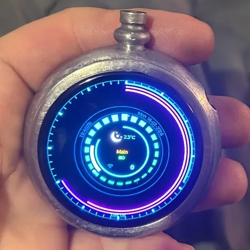

The build itself is fairly simple: [Math] started with a Waveshare dev board that got him the 1.75″ round touch display, along with an ESP32-S3 and niceties such as a six-axis IMU, an RTC, microphone, speaker, and micro SD card reader. That’s quite the pocket watch! The current firmware, which is available on GitHub, focuses on the obvious use case of a very stylish watch, as well as weather and tidal display. Aside from the dev board, [Math] needed only to supply a battery and a case.
[Math] designed the case for the watch himself in Fusion360 before sending it off to be 3D printed in stainless steel. That might not be molecular-scale manufacturing like in the book, but it’s still amazing you can just do that. Ironically, [Math] is a silversmith and will be recreating the final version of the watch case in sterling silver by hand. We’d be tempted to include a door–making it a “hunter’s case” in pocket watch lingo–to protect that amoled display, but far be it for us to tell an artist how to do his work. If you’re not a silversmith, [Math] has stated his intent to add STLs to the GitHub repo, though they aren’t yet present at time of writing.
