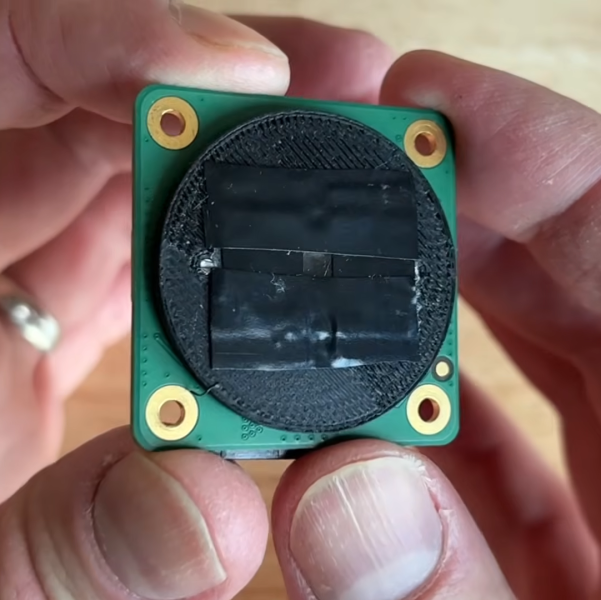

Typically, when we want to take images, we use an image sensor paired with some sort of lens assembly to make a picture that’s sharply in focus. However, [okooptics] is here to show us there’s another way—using Scotch tape in place of a typical lens element.
If you just put Scotch tape over an image sensor without a lens, you’ll just get a blurry image, whatever you point it at. With the right algorithms, though, it’s possible to recover an image from that mess, using special “lensless imaging” techniques. In particular, [okooptics] shows how to recreate the so-called coded aperture techniques which were previously demonstrated in [Laura Waller]’s DiffuserCam paper.
It’s complicated stuff, but the video does a great job of breaking down the optics into understandable chunks. Armed with a Raspberry Pi HQ camera covered in a small amount of Scotch and electrical tape, [okooptics] is able to reconstruct a viable image from what initially looks like a blurry mess of nothingness, with the aid of the right deconvolution maths. It’s all about understanding the point spread function of the tape versus a regular lens, and figuring out how to fight off noise when reconstructing the image.

    1. If you remove the webcam’s lens and replace it with a particular type of diffusing tape a specific distance from the sensor, and go through the painstaking calibration process then, yes, it would defeat that particular security measure. Provided you have a single well-lit target in the middle of a dark field of view, and no other stray light falling on the tape.
    2. It doesn’t. The trick with the tape is to use electrical tape, duct tape, or for the ultra paranoid people who don’t mind cutting their fingers furnace tape. The idea is if no light comes through to the detector, there is no recovery. Can’t recover photons that never made electrical signals.
      If people are using cellotape then they have been doing it wrong.
    3. No, this doesn’t impact using (ideally black or at least opaque) tape to block the lens. This technique only works with tape right up against the bare image sensor.
      1. Actually it requires the tape to be offset from the sensor a certain critical distance to maximize the contrast of the caustics produced. IIRC it’s 3 mm in this case with his particular choice of tape.
