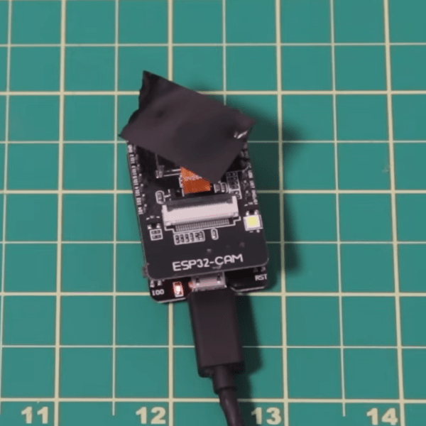

Random numbers are very important to us in this computer age, being used for all sorts of security and cryptographic tasks. [Theory to Thing] recently built a device to generate random numbers using nothing more complicated than simple camera noise.
The heart of the build is an ESP32 microcontroller, which [Theory to Thing] first paired with a temperature sensor as a source of randomness. However, it was quickly obvious that a thermocouple in a cup of tea wasn’t going to produce nice, jittery, noisy data that would make for good random numbers. Then, inspiration struck, when looking at vision from a camera with the lens cap on. Particularly at higher temperatures, speckles of noise were visible in the blackness—thermal noise, which was just what the doctor ordered.
Thus, the ESP32 was hooked up to an OV3660 camera, which was then covered up with a piece of black electrical tape. By looking at the least significant bits of the pixels in the image, it was possible to pick up noise when the camera should have been reporting all black pixels. [Theory to Thing] then had the ESP32 collate the noisy data and report it via a web app that offers up randomly-generated answers to yes-or-no questions.
[Theory to Thing] offers up a basic statistical exploration of bias in the system, and shows how it can be mitigated to some degree, but we’d love a deeper dive into the maths to truly quantify how good this system is when it comes to randomness. We’ve featured deep dives on the topic before.

    1. Cool idea. I guess someone could wrap the mcu in copper tape or blast it to saturation though to bypass it. Unless some of the process involves internal noise on the board itself. I should probably just read the paper.
      1. It likely uses the noise from the WiFi antenna which would include components on the board like amplifiers, filters, even just traces, etc.
    2. “pass the NIST test” means very little – counter fed into SHA1 will pass NIST test (heck even into MD5) but is not random at all
      one key feature for RNGs with physical entropy source is also if it can be influenced from the outside and if it can detect such influence, or any other failure mode – for example what happens if the HW entropy source fails in a way that instead of noise it start to output constant value
      very good source of information about design of RNGs if you don’t have reliable hardware entropy source is here https://www.chronox.de/lrng/releases/v54/lrng-v54.pdf (Stephan Müller – Linux /dev/random – A New Approach)
      in the end, RNGs are cryptography – and rule #1 of cryptography applies here as well (you should never program the encryption algorithms yourself – unless you actually really know what you are doing)
  3. Noise is one of those weird things. I bet for 99% of hobby applications this is a perfectly reasonable entropy source. the noise likely has some dependence on temperature so it’s smart to lean in on the lsb but I don’t know if this is a fair distribution to draw from. So if someone dunked your ccd into a dewer of liquid nitrogen, or more easily plucked the tape off and shined their cellphones flashlight on it they could get all 0s or all 1s. I guess at that point there’s easier things they could do too.
