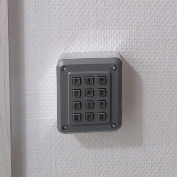

A hackerspace is a place that generally needs to be accessed by a wide group of people, often at weird and unusual hours. Handing around keys and making sure everything is properly locked up can be messy, too. To make it easy for hackers to get in to [Peter]’s local hackerspace, a simple electronic system was whipped up to grant access.
The combined use of QR code & PIN adds a layer of security.
The basic components of the system are a keypad, a QR code and barcode scanner, a stepper motor, an Arduino Nano, and a Raspberry Pi. The keypad is read by an Arduino Nano, which is also responsible for talking to a stepper motor driver to actuate the lock cylinder. A secondary Arduino mounted inside the building is used to control the stepper motor, which actuates the lock cylinder once authentication is complete.
The system works on the basis of two-factor authentication. Regular users authenticate to enter by presenting a QR code or barcode, and entering a matching PIN number. The system can also be set up for PIN-only entry on a temporary basis.
For example, if the hackerspace is running an event, a simple four-digit pin can allow relatively free access for the duration without compromising long-term security. Actual authentication is handled by the Raspberry Pi, which takes in the scanned barcode and/or PIN, hashes it, and checks it against a backend database which determines if the credentials are valid for entry. If so,they command the second Arduino to unlock the door.

    1. For more security it shouldn’t matter whether the enclosure is opened from the keypad side.
      Don’t put the verifying-and-opening-mo-tron in the keypad case. A keypad is for pressing buttons, not for security.

  4. ‘”The keypad is read by an Arduino Nano, which is also responsible for talking to a stepper motor driver to actuate the lock cylinder.”
    Perfectly disclosed built-in vulnerability !!!
    so, get this:
    https://www.ebay.com/itm/165752068122
    and a Torx bits set, and go there:
    50.60289880216728, 8.70102891030175
    and you can enter in one minute. Leave the Arduino for the next visitor.
    1. Looking forwarad to seeing you there ;). The pinpad is what is says on the tin: A pinpad.
      Decisions are taken on the Pi on the inside and command a different Arduino that controls the motor.
      Let’s have a Mate and discuss the thing.
    2. the architecture is way more complex than it looks in this article. the keypad is driven by an arduino, the stepper by another one and a pi is also included, only the keypad-arduino is accessible if you take the keypad apart from the outside.
      Since you know our adress now you are welcome to visit us, the first drink is on me.

  9. I’m not one of Oceans 11 or anything but shouldn’t -all- of the required electronics be on the other side of the door and not on the keypad side?
    1. Placing and activating a Z-Pinch reactor somewhere near would about null any advantages of having it hidden : – ]
  10. Have I got this right? All the electronics, including the Arduino, are in the box on the outside with accessible screws? Did it not occur to them that this is a dumb idea? That only the keypad should be outside the door?
    Never mind having the PIN code, you are allowed to access the hackerspace if you can work out how to unscrew the PIN pad and drive the motor directly!
    1. The author of the Hackaday article incorrectly described the project. It’s a little hard to parse from the original article, but there’s one Arduino in the keypad, and another that drives the stepper motor for the lock mechanism, both connected to a Raspberry Pi in the “middle”.
      Kind of disappointing that the summary makes the project look like it has such a glaring vulnerability.
